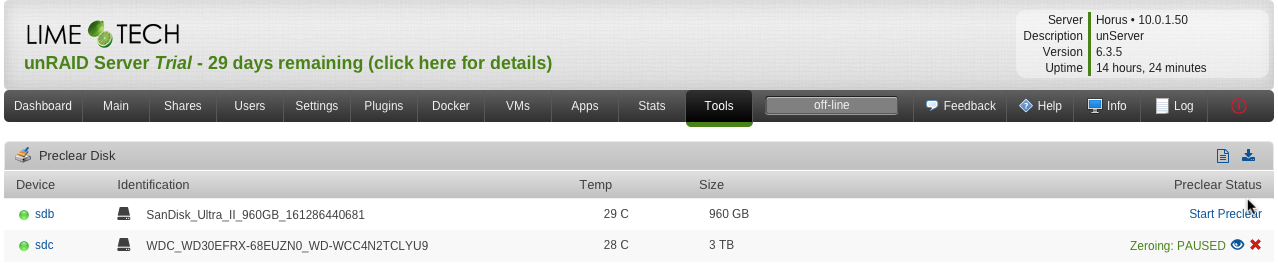

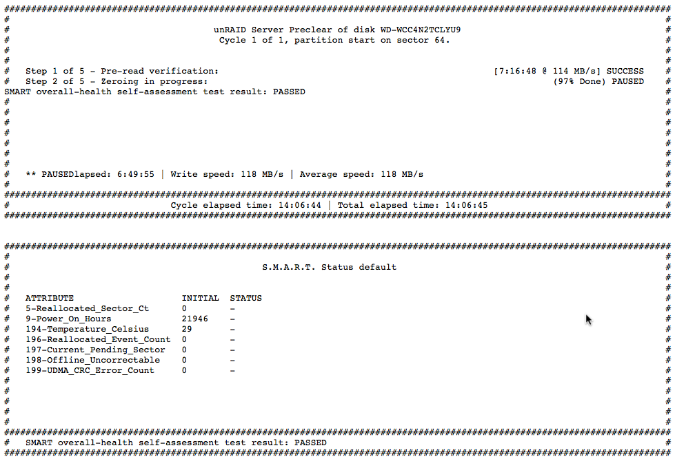

July 23, 20179 yr Hi All, So just started my first unRAID build, added my first WD 3TB Red, downloaded the Preclear Disks plugin and started it off, the first Pre-read has completed after 7 hours, moved onto the Zeroing, and at 97% has just paused and I can't find anyway to unpause it and get it to continue. When I look at the preview report it isn't showing any issues, and the server seems fully working? Can anybody advise me please?
July 23, 20179 yr Community Expert You might want to read the last few pages of the support thread for the preclear plugin. I seem to recall that you are not the only one with this issue.
July 23, 20179 yr Author 26 minutes ago, Frank1940 said: You might want to read the last few pages of the support thread for the preclear plugin. I seem to recall that you are not the only one with this issue. Will do, thank you. Edited July 23, 20179 yr by MacGeekPaul
