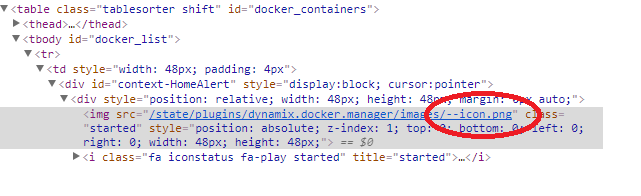

I've a private docker registry. When I add a docker image e. g. myreg:5000/unraid_dockers/mydocker a wrong icon is displayed for this docker (it's the same icon as from the docker I installed first from the private registry). Under /boot/config/plugins/dockerMan/images/ the displayed icon has the filename '--icon.png'. It seems that the implementation for the image caching has problems to decode the docker image name.

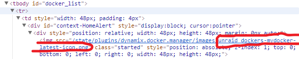

please look at attached docker.xml. Using "myreg:5000/unraid_dockers/mydocker" as the repository, the icon ist not displayed correct. In the html-code of the docker-containers page the icon is "--icon.png" (see attached "incorrect icon html.png"). Using "unraid_dockers/mydocker" instead as the repository (everything else is the same) the icon is displayed correct. In the html-code the icon is "unraid_dockers-mydocker-latest-icon.png" (see attached "correct icon html.png").
