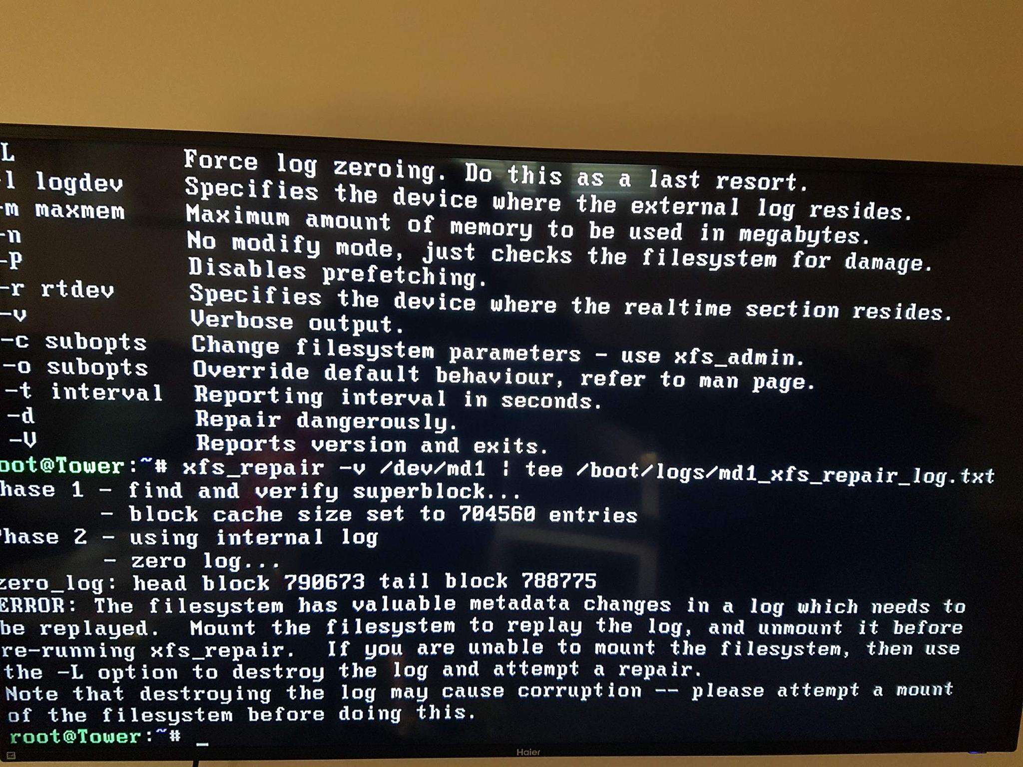

When I used the command this is the result. Have no since tried to mount disks.
You didn't get the nicer message unfortunately... No worries though I've seen that one before and resolved it and everything seemed fine afterwards, however others here are more experienced than I am and you can wait for them to comment if you want to be 100% sure. Might mean a file or two is corrupted, but honestly I don't ever know anyway better solution at this point when you get that message.
If you want to move forward add the L to the command: xfs_repair -Lv /dev/md1

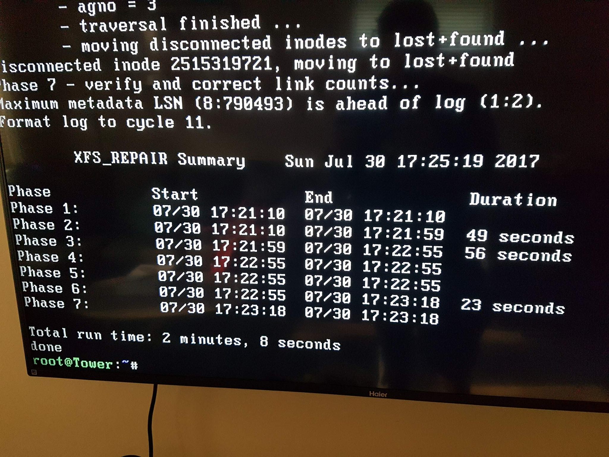

Ok, so that command has run. Quite a long output that it went through. This is the final screen though.
Great, stop the array and then start it in normal mode. See if it works now. If still having issues, attach the diagnostic logs again.
@Lev You are a saint. I just got home and went to start it. Worked perfectly. I really appreciate your help and advice.
