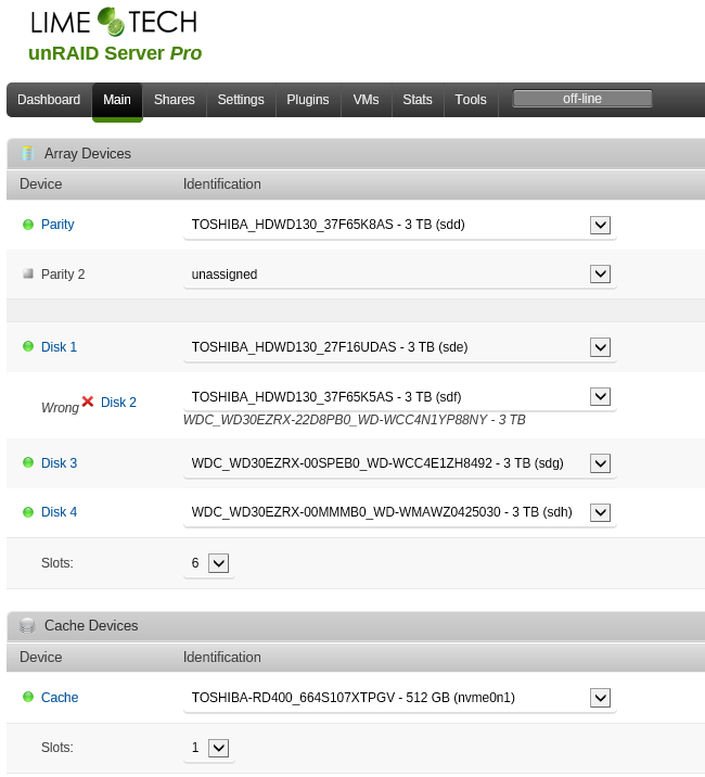

Just had a minor issue during disk replacement, "disk2" is not aligned, same with other browser and other themes, strange thing is I replaced disk1 yesterday and pretty sure it looked normal, will replace disk3 tomorrow, so I'll check if it happens again.

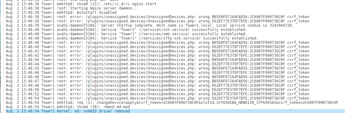

PS: another minor issue, when unselecting "errors" from the syslog to hide them, wrong csrf_token errors start appearing in white along with all the normal text, and the only way to hide them is to unselect "text".

Not sure it is a good idea to log the csrf_token:
Aug  2 11:18:49 MediaServer emhttpd: req (9): csrf_token=6C6B8589F3F3AC81&title=System+Log&cmd=%2FwebGui%2Fscripts%2Ftail_log&arg1=syslog
Aug  2 11:18:49 MediaServer emhttpd: cmd: /usr/local/emhttp/plugins/dynamix/scripts/tail_log syslog
This is expected behaviour. With "text" checked colours can be enabled or disabled for the respective categories but ALL text stays visible. With "text" unchecked only the selected categories are displayed.
Maybe I misunderstood how it works but then why are the other errors hidden when I uncheck errors, only the csrf_token errors turn white and stay visible?
Yes, you're right, all errors turn white when unselected, may bad.

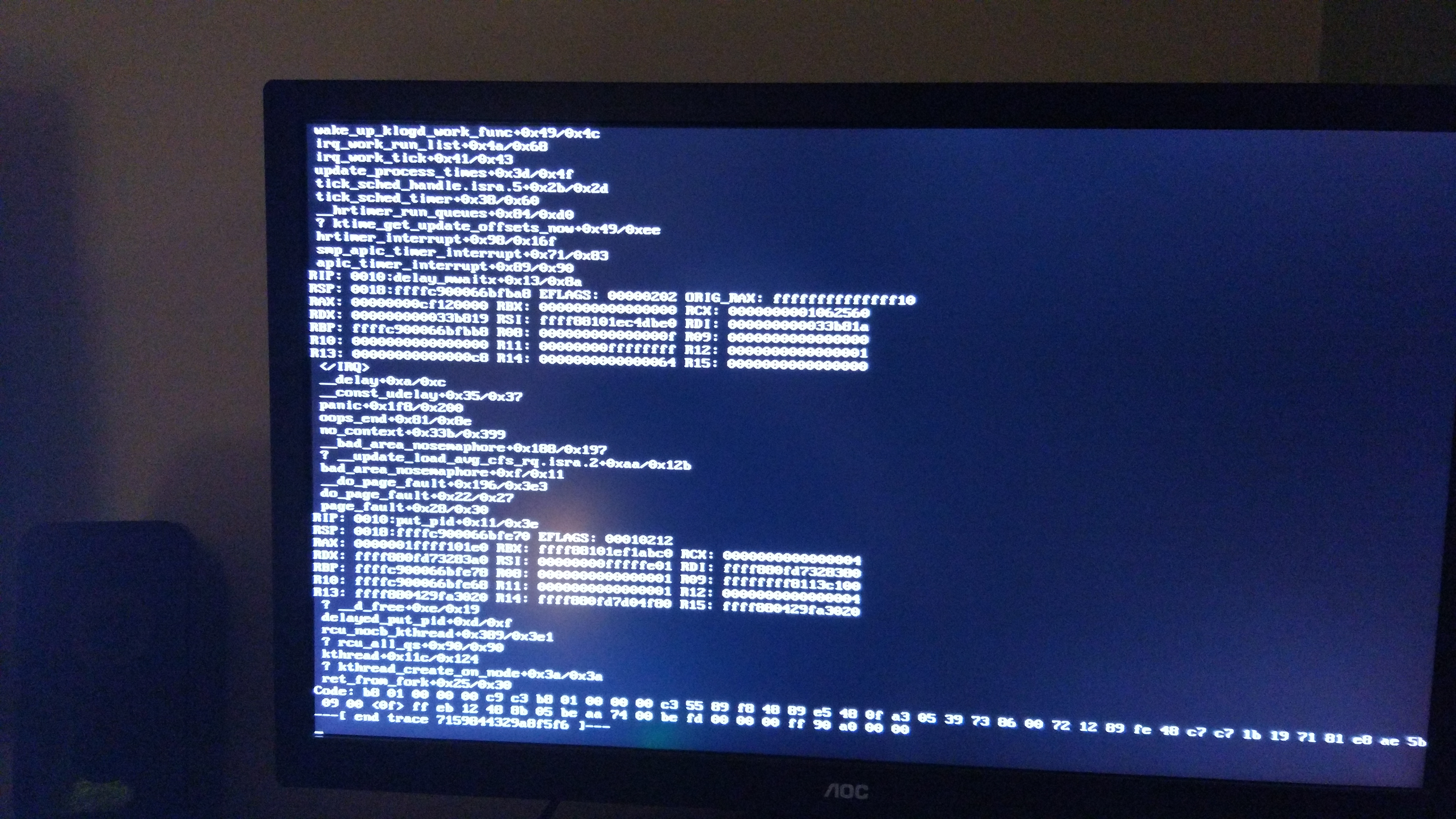

On 7/30/2017 at 4:35 PM, Frank1940 said:
Install the 'Fix Common Problems' plugin and turn on the trouble shooting mode.   You could also try a monitor connected to the server and see if there is any useful info on the screen after the lockup.
I installed a fixed a few random things, but nothing that seemed major.  I connected a monitor and the only thing visible was a flashing dash in the upper left corner of the screen.
This was my second try.  I upgraded around 4 PM and by the time I woke up, it was frozen.
Slightly off topic, any thoughts on those Toshiba drives?  Are they Hitachi drives with different labels still?
I quite like the look of the 8TB Toshiba NAS drive, and to my eye it looks identical to my old HGST 4TB NAS drives.
