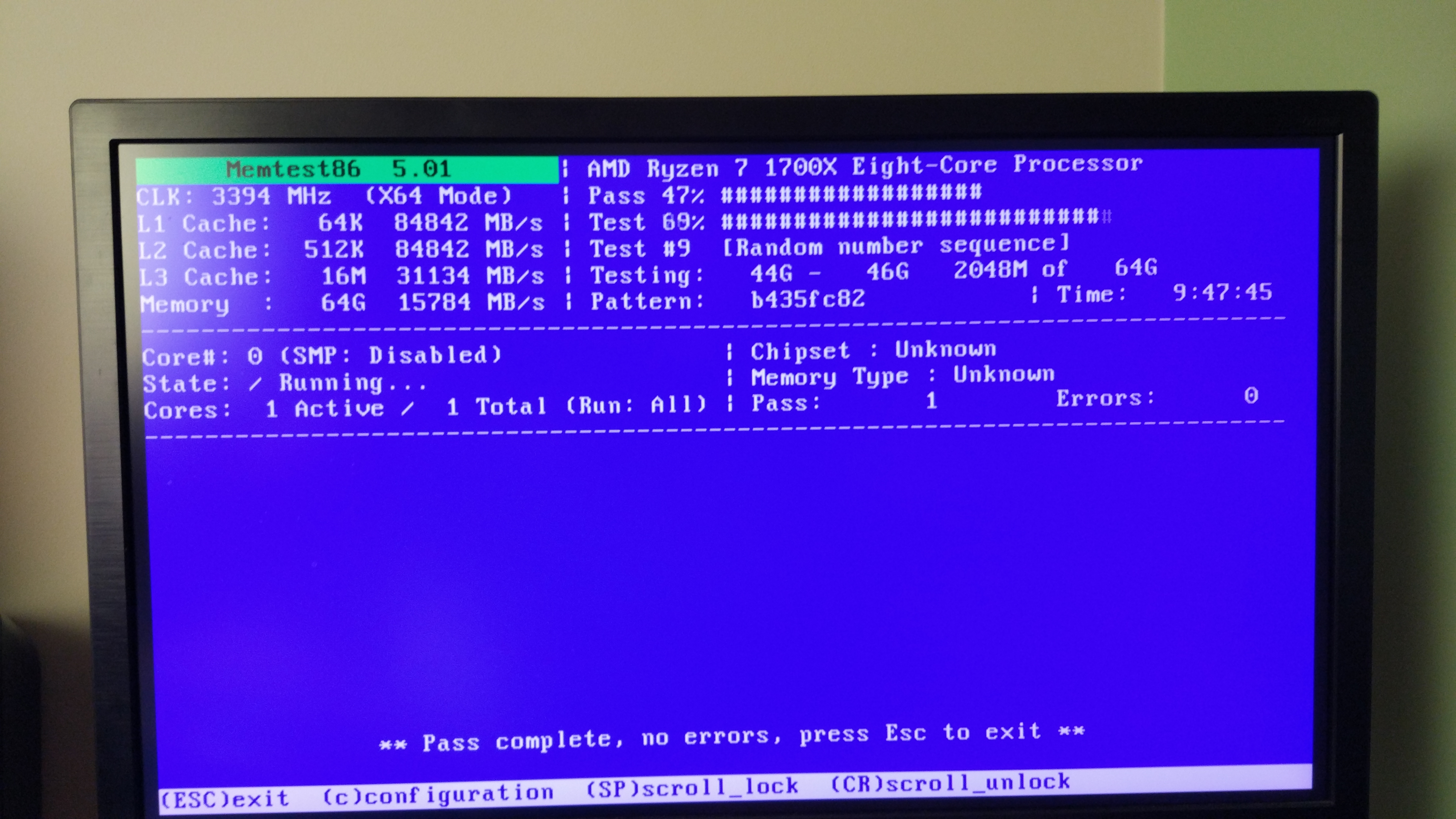

Running this since release now, no issues as far as I can tell.
AMD GPU/NIC Passthrough, dockers, etc all seem to be working A-OK!
10 hours ago, Squid said:
But have you actually run it?
Sent from my LG-D852 using Tapatalk
Memtest is ok.
Edited by r4id

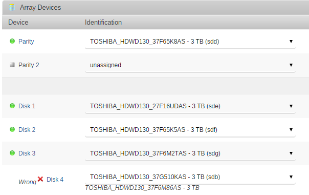

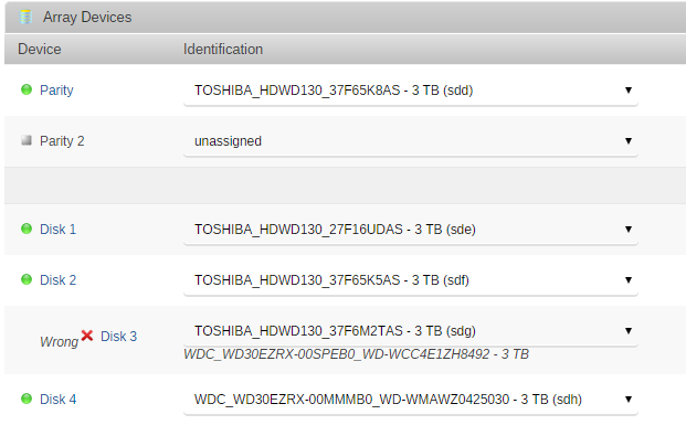

On 02/08/2017 at 1:59 PM, johnnie.black said:
Just had a minor issue during disk replacement, "disk2" is not aligned, same with other browser and other themes, strange thing is I replaced disk1 yesterday and pretty sure it looked normal, will replace disk3 tomorrow, so I'll check if it happens again.
Still happening, but only with these Toshiba disks, so I'm guessing it as something to do with their identifier length.

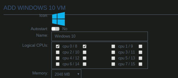

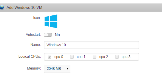

On 7/30/2017 at 0:04 AM, saarg said:
I can confirm there is a bug that makes it impossible to choose cores if you have 8 or less cores when creating a new VM.
If there are more than 8 cores available the first 8 are grayed out until you choose a core above core 8. Then all are available for selection.
Created a new VM on my test machine which has 4 cores. I can choose which ever core I want.
What exactly do you observe, maybe some screenshots may help?
Corrected in next version.

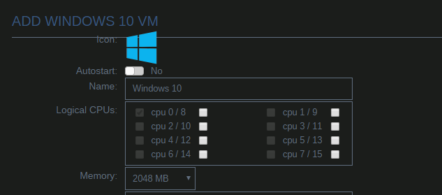

Below you'll see that when I create a new VM on a computer with only 4 cores, I can't choose any cores or deselect core 0.
On my 8 core Xeon I only get half the cores to choose from until I select one of them, then I get the full 16.
Both me and @CHBMB see this. I used chrome and I think he used both chrome and firefox. cache cleared.

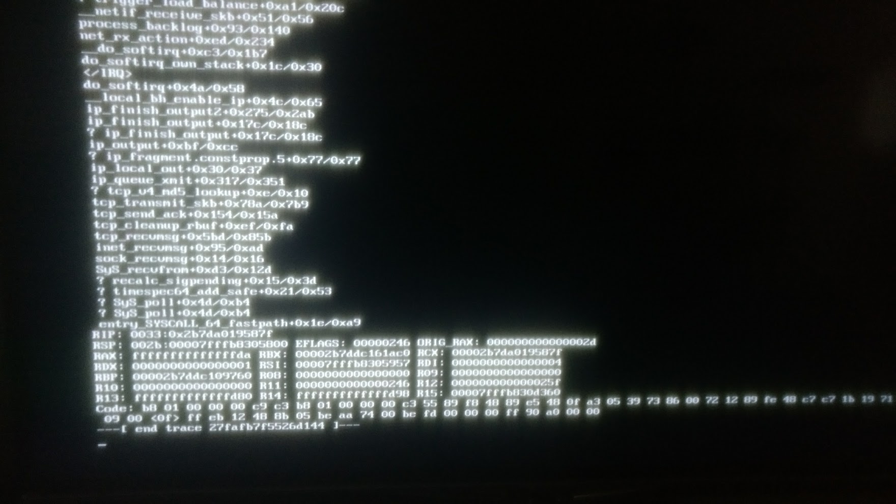

On 8/4/2017 at 10:00 AM, r4id said:
Yes, my server having freezing issues, when no load.
unRAID OS version 6.4.0-rc7a
M/B: ASRock - X370 Gaming K4
CPU: AMD Ryzen 7 1700X Eight-Core @ 3400
HVM: Enabled
IOMMU: Enabled
Cache: 768 kB, 4096 kB, 16384 kB
Memory: 64 GB (max. installable capacity 64 GB)
Same M/B and CPU here, with rc7a, it was idle and completely stable for at least a week (was rebooted by us after that for other testing).
There are BIOS updates (AGESA 1.0.0.6a) for both the ASRock and Gigabyte M/Bs you've tried, you may want to apply those if you haven't already.
It might also be helpful if you posted your diagnostics zip file (Tools --> Diagnostics from the web ui) here on the forums so we can take a look to see if there's something else that stands out.
I have the same results on my 8-core Ryzen whether in Chrome/Firefox/IE on another device or using Firefox on the rc7a server (all cache cleared, inside or outside of safe mode). Half of the 16 threads are grayed out when creating a new VM until I select one of the available choices in addition to cpu 0.
I am also having this issue on my intel dh77eb with an i5-3330 cpu. All 4 cores are greyed out. Only additional thing i have is a usb controller which shows up under "other pci devices" and my ups under "usb devices". I have tried using chrome and ie. Cache was cleared on ie.

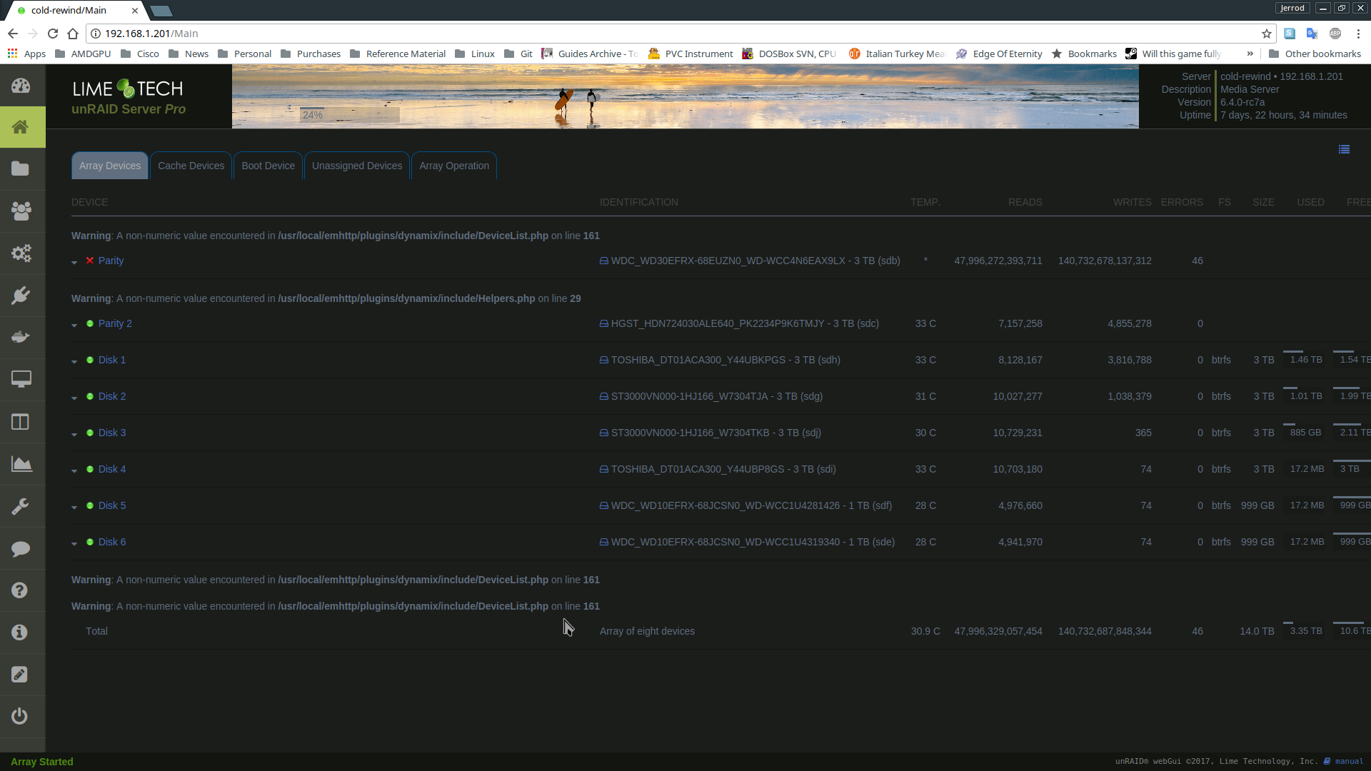

I've found something interesting. I had my parity drive fail on me. it was getting some read errors every week so I tried moving it to another slot, issues persisted, then the drive failed and was gone. since the drive is no longer registering my webUI is doing something strange.
Lucky for me (or is it?), the drive is still under warranty. I'll be sending it back for RMA later.
cold-rewind-diagnostics-20170807-1709.zip
Thanks for the details, cpu selection is fixed in next release.
8 hours ago, Darksurf said:
...since the drive is no longer registering my webUI is doing something strange
Thanks for reporting, fixed in next release.
I removed the usb rapoo (wireless keyboard) and the system has been running stable for 2 days :)
