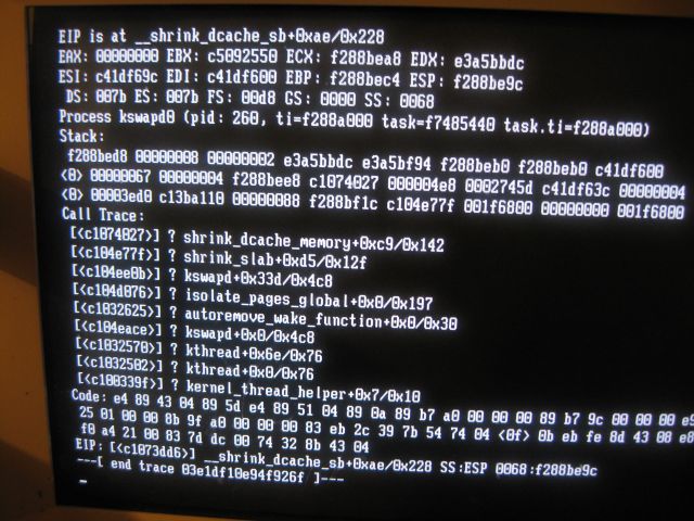

unraaid 4. Crash
I was copying some files from the array to the array.  Very slow choppy copies.  Then nothing.  checked the console and saw the attached picture.
Any idea's on the cause?

Somethimes when the system runs out of RAM, Some addons can cause the OS to crash, but you have a lot of swap configured so it shouldn't be a problem. Normally when unraid crashes it can be some from of curruption (either software or hardware related), in which RAM can be a possible point of failure (followed by dodgy cabling and possibly your system board). The best thing to start off with would be your cabling or hardware to see if all is seated and connected properly. When your satisfied with the hardware sitting and connected fine, I'd suggest to restart your server, at the bootmenu select the 'memtest' option to do a thorough Memory Test, perhaps as long as possible and several passes to see any issues with your RAM module(s). If RAM comes up file, it could possibily be your USB drive either the FAT file system currupted or the drive itself has gone bad. You should copy the /boot/'config' folder and all it's contents onto a secure location, format the USB drive again using a full format and redo the drive again, copy the new OS files like you were preparing your USB drive for the first time and then copy back your 'config' folder you backed up earlier back onto your newly prepared USB drive, start your server and fingers crossed. Hope this helps.
You don't have enough ram to run cache_dirs and untorrent. something happened with swapping and shrinking the directory cache. There must have been pressure for ram.

The screen capture below showed a failure while the kernel was shrinking the directory cache.
Yet there is a program forcing this cache to stay used.
There could be a log running away. in any case, not enough real ram and swap can be used for certain types of ram conditions.
