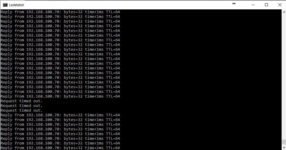

Streams stops when streaming, Ping also times out
Hi, I have set up a new Unraid server.
everything seems to work fine, but when I copy or stream movies of the server. I get small hang-ups.
but they are enough to stop the movies or tv series completely.
have tried moving the drives over on another computer but still same problem.
also tried another network cable and another port on the switch.
I have another Unraid on same switch with no problems.
hoping someone could find the answer.
best regards
Christer Fresh

problem is on low bitrate streams also.
tried rebooting every network device yesterday.
can see there is one transmit error in dropdown menu.
disabled bonding, still the same :(

I am not a Guru in looking at syslogs but I did take a look at yours.  The only thing that I saw was these entries at the end of the syslog.
Jul 30 17:34:58 Smal-NAS kernel: br0: received packet on eth0 with own address as source address
Jul 30 17:36:54 Smal-NAS kernel: br0: received packet on eth0 with own address as source address
Jul 30 17:39:00 Smal-NAS kernel: br0: received packet on eth0 with own address as source address
Jul 30 17:41:04 Smal-NAS kernel: br0: received packet on eth0 with own address as source address
Jul 30 17:43:19 Smal-NAS kernel: br0: received packet on eth0 with own address as source address
Jul 30 17:45:20 Smal-NAS kernel: br0: received packet on eth0 with own address as source address
Jul 30 17:47:24 Smal-NAS kernel: br0: received packet on eth0 with own address as source address
Jul 30 17:49:24 Smal-NAS kernel: br0: received packet on eth0 with own address as source address
Jul 30 17:51:30 Smal-NAS kernel: br0: received packet on eth0 with own address as source address
Jul 30 17:53:43 Smal-NAS kernel: br0: received packet on eth0 with own address as source address
Jul 30 17:55:45 Smal-NAS kernel: br0: received packet on eth0 with own address as source address
Jul 30 17:57:47 Smal-NAS kernel: br0: received packet on eth0 with own address as source address
I googled this message and it seems to be a problem that has been seen before.  It seems to be related more to the network side of the issue.  I compared your network.cfg file to mine and found several differences.  (I have both bridging and bonding turned-off on both of my servers.)  I suspect that either bridging and/or bonding has been set up for your NIC.  Did you see this post from @unevent?

It appears the br0 bridge is causing ARP issues.  Try disabling the bridge, assuming you have no Dockers or VM configured/running.  Don't have the time at the moment to get deeper.  Perhaps others may be able to help more.
Seems like that did the trick :D  (disabling bridging)
but that means i cant use docker or VM's  ?
