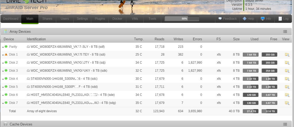

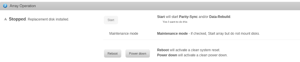

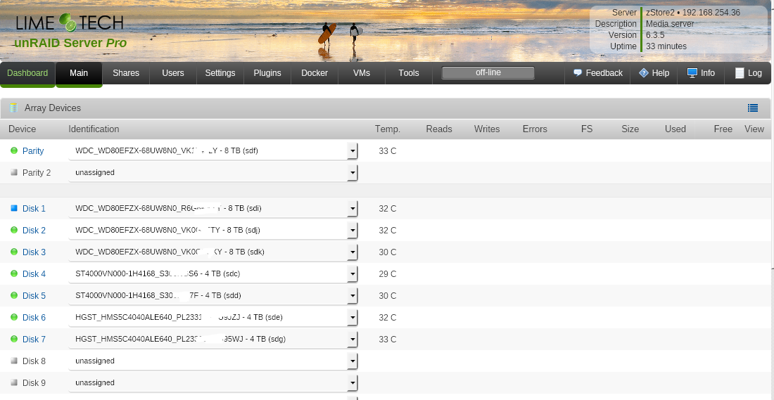

I have a few problems with my Unraid Pro 6.3.5 at the moment. I have a supposedly failed 8TB WD red after only 6 weeks (suspisious) but I have just sourced a replacement and on installing ot I do not get a clickable start button. Extracts of the status page following to show situation.
and at the bottom
It seems to say everything it should but does not enable the actions I need to get a rebuild happening. Why not?

Worked that out. Modified original post. Refresh to see it.
Are you using Firefox?    If so your problem is a bug in the latest Firefox in handling of checkboxes.    It is not showing the checkbox against the “Yes I want to do this” text that needs to be checked to enable the Start button
As itimpi said, this is a known issue with Firefox v54, it doesn't show checkboxes. Use a different browser.
Well i'll be darned. How long has that been the case? If that checkbox for Unraid is the only thing I have seen that doesn't work in firefox then that makes it Firefox's fault?
Anyhow, thanks for the quick assist.

It was introduced in Firefox when they released version 54 (prior versions were all okay). Bug has been confirmed by Mozilla and will be fixed in a future release.

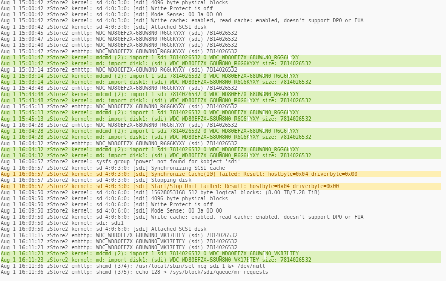

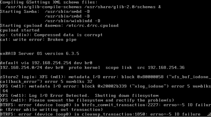

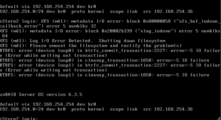

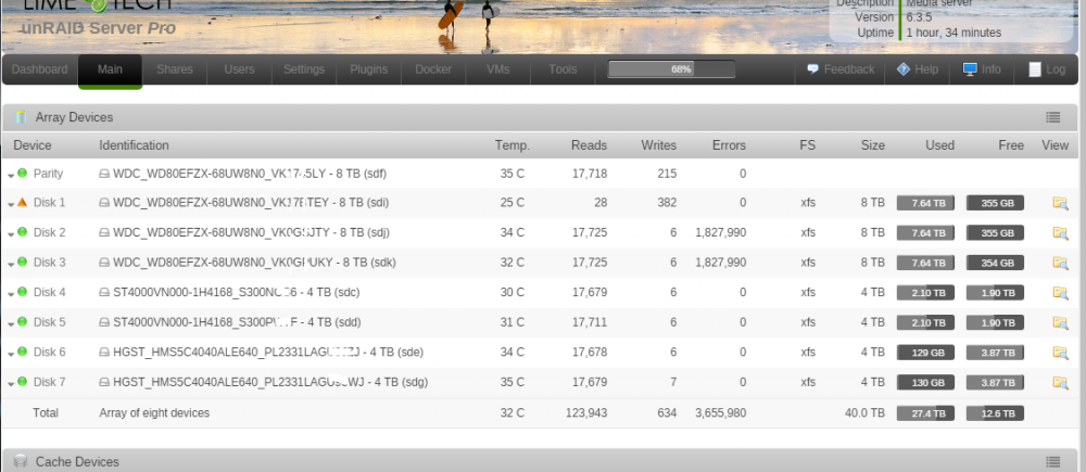

Hmm. May have made a bit of an error in judgement. Decided to try rebuild on the original disk suspecting it of not actually being faulty, now that I have a spare or 2 available, after all it had a clean SMART status and passed the short test OK. But it looks to have blown up badly. The below console errors were thrown and the rebuild was logging massive errors on disk2 and disk3.
I stopped the rebuild after only a minute or so but on stopping the array, the GUI is not responding but I can log into CLI. Any advice on how to proceed? I want to retry the rebuild with the replacement drive this time.
5980220cda3c0_Rebuildfailing-diskerrors.thumb.PNG.8aecbb9a456902df680c4287eb9bdf08.PNG
First thing you need to do is run a check and repair on your USB stick (you can use Windows for that). You better download the zip file again and copy its content to the USB stick. Currently there is corruption on your USB stick.
Reboot your system with the new drive installed and let it rebuild disk1.

Also the errors I see in what I sent all say XFS(array) or BTRFS(cache) so what clued you to a USB problem?

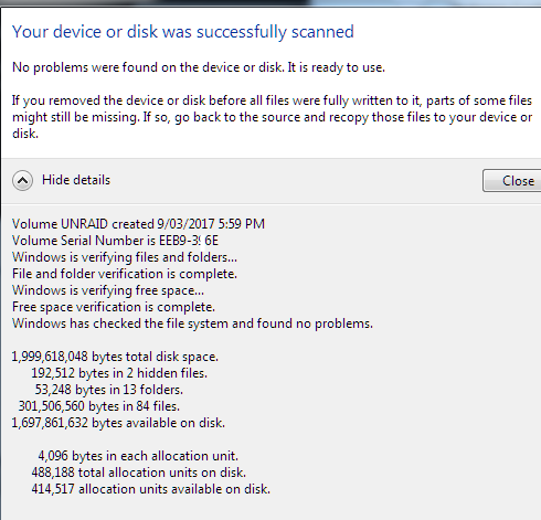

OK. Have done all that.
Windows prompted for repair (impropper dismount) on plugging in the USB.
Did full scan and repair. No errors found.
Re-copied over content of 6.3.5 download and reran makeboot.

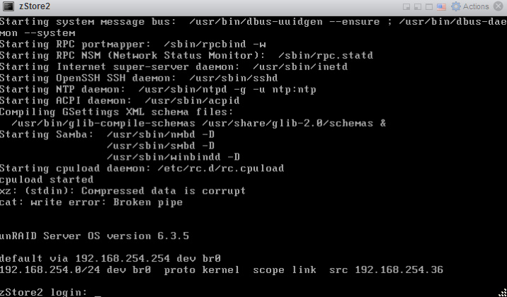

booted and running but this error on the console again after boot.
What is the lines
xz: (stdin): Compressed data is corrupt
and
cat:write error: Broken pipe
errors about?
Are these what was concerning before in the output from Yesterday? Like today, these errors come up at first after boot. They did not coincide with the problems with the rebuild yesterday.
These errors indicate something wrong with the image itself. Did you download a new image from the Limetech site?
