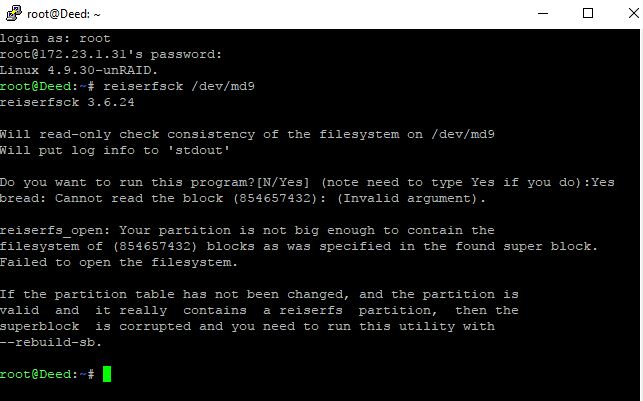

stop the array, start in maintenance mode again and run reiserfsck on the emulated disk9 and post the output:
reiserfsck /dev/md9

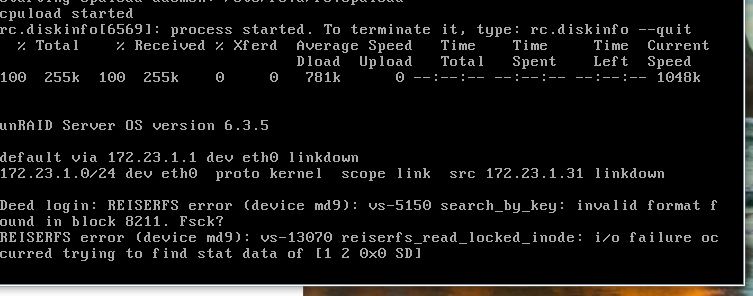

Ok I get to console and see the following attached picture1--this came up after one of the initial steps I believe.  So I putty'd in and was able to login that way and got the output shown as picture2.
Edit:  I should add that doing anything in console in this top picture didn't respond--could not get a login prompt etc.

Superblock is damaged, this is not normal, could be the result of the problems with the original disk9 or there were changes to the array after the disk13 upgrade attempt, any change, like dockers writing to the array, etc will cause problems.
You can still rebuild the superblock and see how it goes, follow the instructions from here:
https://wiki.lime-technology.com/Check_Disk_Filesystems#Rebuilding_the_superblock

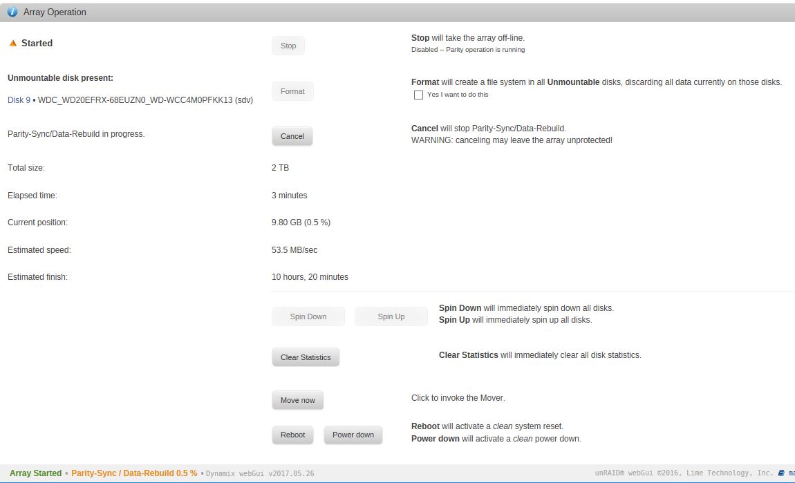

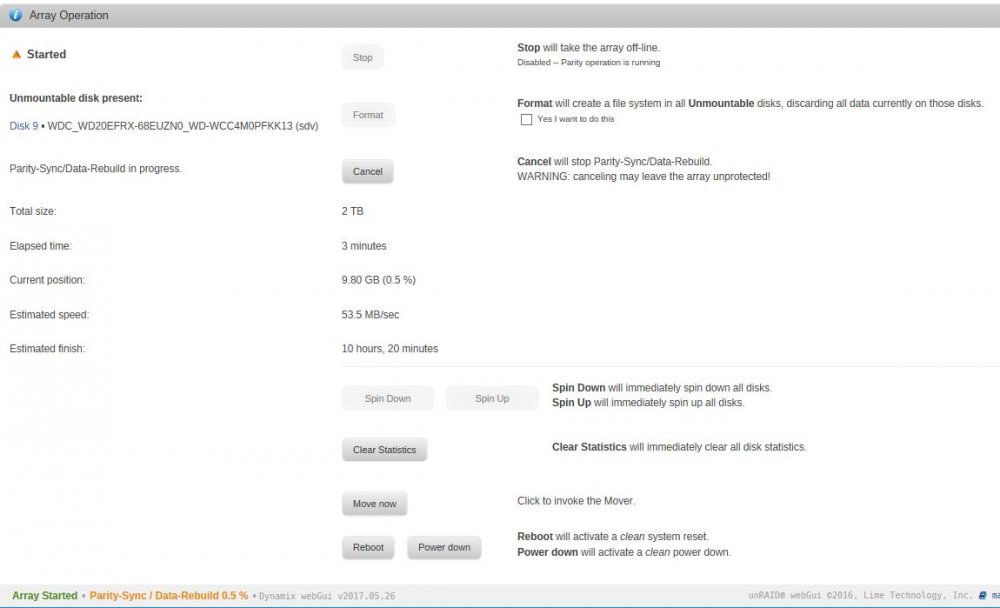

Then I unmounted the array, assigned the new disk9 and brought the array online and now I see the following:
Should I be concerned that it states "unmountable"?  It appears to be rebuilding but never been here before....thanks!
I would wait until it finishes and then see what it says...  (As I recall, it will say that until the disk has been rebuilt.)  If it is unmounted, @johnnie.black  will probably be around to give you further advise.  (I think he is somewhere in the British Isles so it is the middle of the night there.)
Many thanks Frank! You both have been incredible!
Wait until the rebuild finishes then run reiserfsck --rebuid-tree, that will take several hours but it should fix it.

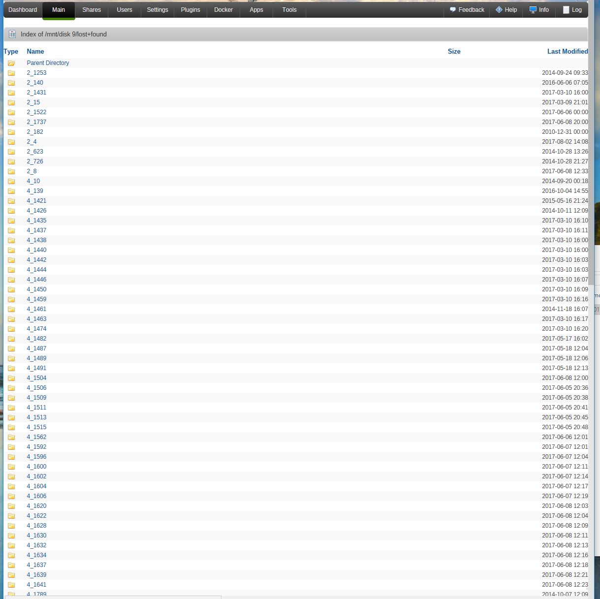

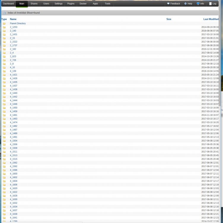

 Ok I ran it and it completed....then had to stop the array and restart it.  It allowed disk9 to be mounted and I can now see the disk share but nothing is there except "lost and found".  Can't browse the share with windows but can under the gui.  Tons of folders in there and files as well of the correctish sizes I presume.  Assume I have to open them up to read them etc?  They are named with simple numeric sequences--see attached picture.
Attached is the output of the --rebuild-tree.
rebuild-tree.txt
And I suck...was trying to access via disk9 and NOT the users share lost+found.  Buried under those original directories are my ACTUAL directories and files!  Tried a couple and they seem to work perfectly.  I think we're done here...time to check and move!

Actually windows gave me a permissions error and when I started poking around I realized I was under disk9/lost+found and not \\tower\lost+found.  I'm assuming all I have to do is move the files from \\tower\lost+found to their respective \\tower\sharename and I'll be set no?  Or is a more complex move needed?  Usershare to usershare if I'm not mistaken...
Yep.
