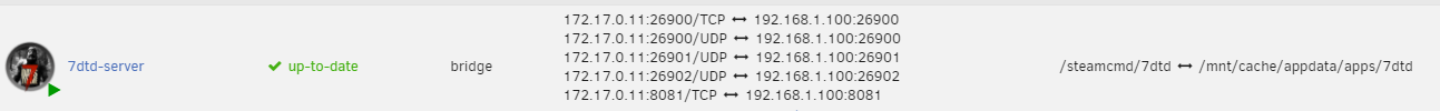

Just to follow up on this, emulation flag has been enabled in Unraid (at least on version 6.6.6 that I am running now, not sure where it got changed) so we can now run dockers like this 7dtd server and other steamcmd servers.
- For setup, I went into apps. Bottom left in settings I made sure to enable DockerHub. Went back to apps, did a search for "7dtd" (which reveals no results, but also a link to dockerhub). Once clicked on the link it shows me various versions of it, I used the one from didstopia.
- This brings up the docker setup menu. I went to the dockerfile and looked up the folder, ports and variables I need to set. I set up a path for /steamcmd/7dtd to a folder on my cache drive. Set up all the ports, and set up all the variables (in case I need to change them in the future they will be ready). See below for an example (though the variables aren't shown in this view). Note that you don't need to add "" as part of the keys, just type in the stuff and it adds it automatically.
- I set up port forwarding on my router for 26900 thru 26902 to my unraid server.
- The docker was started the first time for it to build and download all the files though it promptly crashed (using A17.2). Stopped the container.
- Had to log in thru telnet to the server. Go to my 7dtd folder on the cache and navigate to the server_data folder. This is where the real serverconfig.xml is stored (ignore the one in the main 7dtd folder). I had to "chmod 777 serverconfig.xml" in order to make changes.
- Then I navigated to my folder thru SMB and found this serverconfig.xml file and opened it using Notepad++ (not the regular notepad). I had to delete the complete lines for ZombiesRun and BlockDurabilityModifier. This is critical, I tried to comment them out but didn't do it right, took me a while to find out that I just needed to completely wipe it out to make sure I was doing it right.
- I went ahead and altered the files to my preferred settings, and I added some of the new setting for A17.2. See this.
- After this it was able to start, and I was able to log in.
