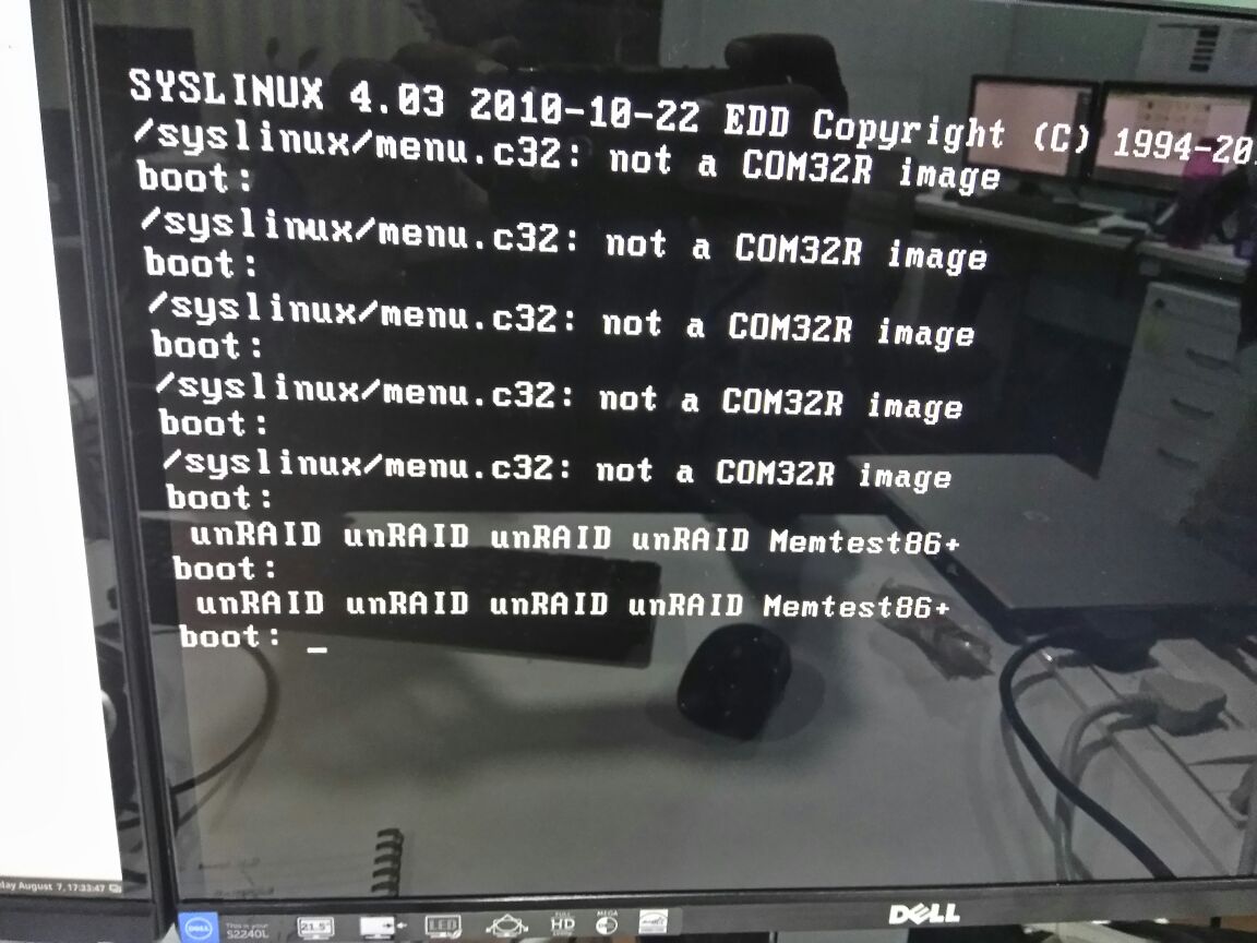

August 7, 20179 yr Author I have been receiving the "menu.c32: not a COM32R image" error for quite some days. Not sure which upgrade broke it. I type unRAID everytime and then it boots up normally. Now since I have fixed other issues(Power Supply was the main cause of it and replaced it with Seasonic 750W) need this to be completely headless. Can someone let me know how I should fix the error?
August 7, 20179 yr 3 minutes ago, sabarirjpm said: I have been receiving the "menu.c32: not a COM32R image" error for quite some days. Where are you seeing this? Where are you typing "unRAID" to fix this? (Post a cellphone pic if necessary). But it sounds like you've corrupted (or the P/S did) the flash drive. Download the zip file from Limetech's website, extract the files from it back onto the flash drive, and re-run the appropriate make_bootable script.
