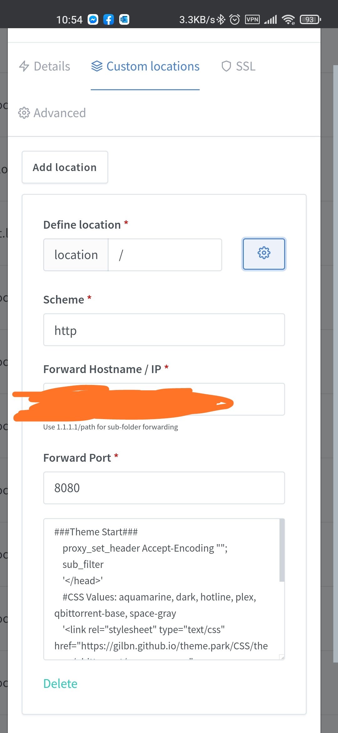

22 minutes ago, xMaverickx said:
Ok, great. I use NPM as well, so in theory this should work for me as well, but I edited the proxy host in NPM and copy and pasted exactly what you wrote above in the custom configuration and nothing seemed to change. I checked the config file directly as well and the code is there.
Not sure why. Any ideas? Many thanks for helping.
Go to custom location, for path put "/" without quotes and edit this location with this code
Sent from my Mi 10 Pro using Tapatalk
Edited by skois
That did it. Thanks for the help!
Np😉
Is it possible to get this working on LetsEncrypt conf file too?
edit: figured it out for anyone else who might want to theme:
create a file called whatever (I used theme-park.conf and add it into the letsencrypt nginx folder
edit it to add these lines:
    proxy_hide_header   "x-webkit-csp";
    proxy_hide_header   "content-security-policy";
    proxy_set_header Accept-Encoding "";
    sub_filter
    '</head>'
    '<link rel="stylesheet" type="text/css" href="https://gilbn.github.io/theme.park/CSS/themes/qbittorrent/space-gray.css">
    </head>';
    sub_filter_once on;
then just add this line to your qbittorrent conf in the first "location / {" area
       include /config/nginx/theme-park.conf;
done!
