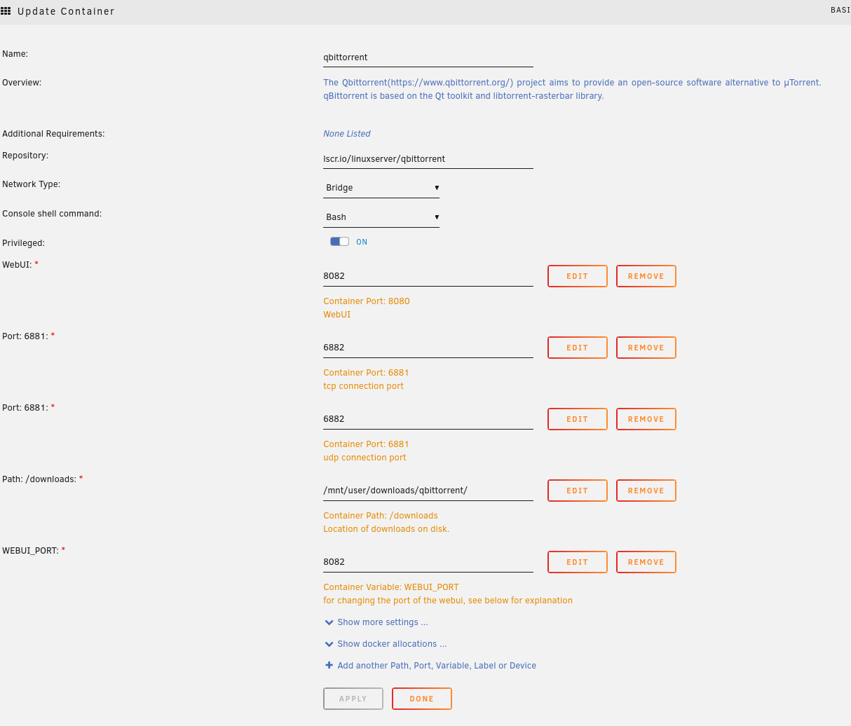

On 7/19/2022 at 2:06 PM, gaikokujinkyofusho said:
For some reason I cant seem to access the webgui, everytime I try to I get:
Unable to connect
Firefox can’t establish a connection to the server at localhost:8082.
have tried using my lan ip 192.168...:8082
same error.
I figured I might be asked about logs and settings so:
s6-rc: info: service s6rc-oneshot-runner: starting
s6-rc: info: service s6rc-oneshot-runner successfully started
s6-rc: info: service fix-attrs: starting
s6-rc: info: service 00-legacy: starting
s6-rc: info: service 00-legacy successfully started
s6-rc: info: service fix-attrs successfully started
s6-rc: info: service legacy-cont-init: starting
cont-init: info: running /etc/cont-init.d/01-envfile
cont-init: info: /etc/cont-init.d/01-envfile exited 0
cont-init: info: running /etc/cont-init.d/01-migrations
cont-init: info: /etc/cont-init.d/01-migrations exited 0
cont-init: info: running /etc/cont-init.d/02-tamper-check
cont-init: info: /etc/cont-init.d/02-tamper-check exited 0
cont-init: info: running /etc/cont-init.d/10-adduser
cont-init: info: /etc/cont-init.d/10-adduser exited 0
cont-init: info: running /etc/cont-init.d/30-config
cont-init: info: /etc/cont-init.d/30-config exited 0
cont-init: info: running /etc/cont-init.d/90-custom-folders
cont-init: info: /etc/cont-init.d/90-custom-folders exited 0
cont-init: info: running /etc/cont-init.d/99-custom-files
cont-init: info: /etc/cont-init.d/99-custom-files exited 0
s6-rc: info: service legacy-cont-init successfully started
s6-rc: info: service legacy-services: starting
services-up: info: copying legacy longrun qbittorrent (no readiness notification)
s6-rc: info: service legacy-services successfully started
s6-rc: info: service 99-ci-service-check: starting
s6-rc: info: service 99-ci-service-check successfully started
[migrations] started
[migrations] no migrations found
          _         ()
         | |  ___   _    __
         | | / __| | |  /  \
         | | \__ \ | | | () |
         |_| |___/ |_|  \__/
Brought to you by linuxserver.io
To support LSIO projects visit:
https://www.linuxserver.io/donate/
GID/UID
User uid:    99
User gid:    100
[custom-init] no custom files found exiting...
[ls.io-init] done.
******** Information ********
To control qBittorrent, access the WebUI at: http://localhost:8082
screen shot of settings attached.
