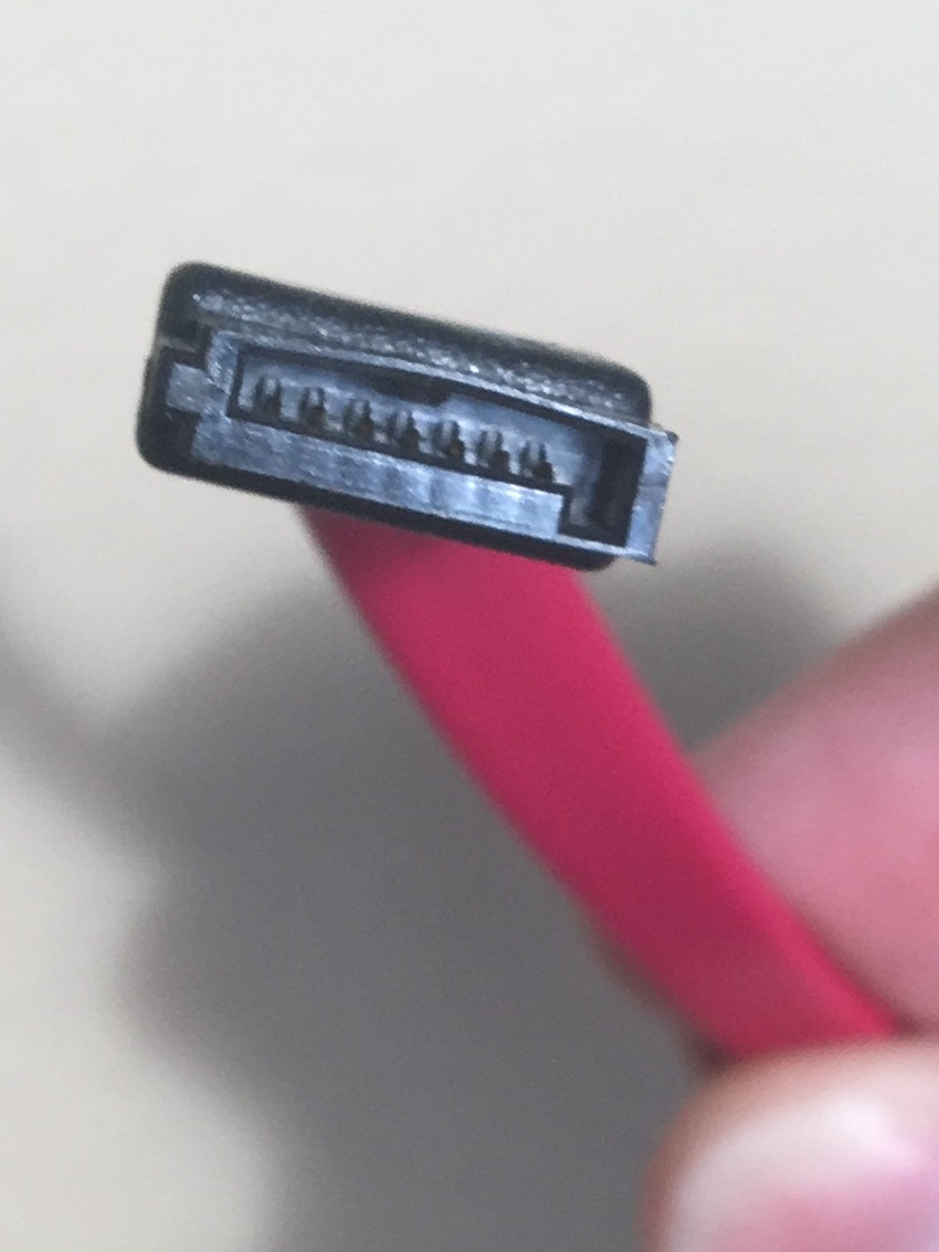

In other news, I see this error again (perhaps it never went away)
Aug  2 15:07:40 Tower kernel: ata4: exception Emask 0x10 SAct 0x0 SErr 0x4040000 action 0xe frozen
:S:S:S:S:S:S
I'm going to shut everything down and double check cables--AGAIN!! before bringing the cache pool back online.
*HEAD-DESK!*
UPDATE:
I think I have everything back in order. Its unconfirmed, but I believe all errors--on the protected array and cache--were a result of one or both bad data cables on the cache drive. I've attached a photo so others can see that just the slightest bit of warping on the connector may have been the culprit... which I suspect this was caused by heat over time. I've replaced both cables with locking ones. That said, my thoughts are they too are not immune to warping.
