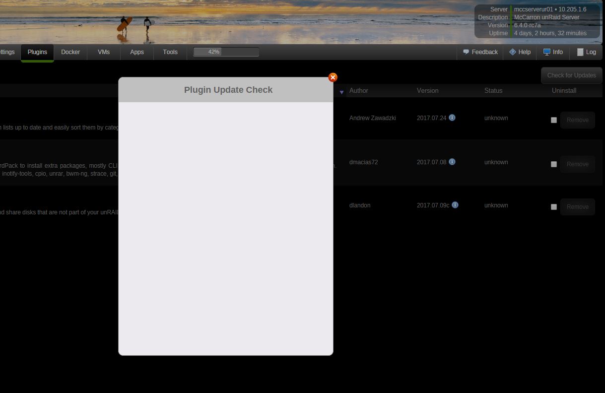

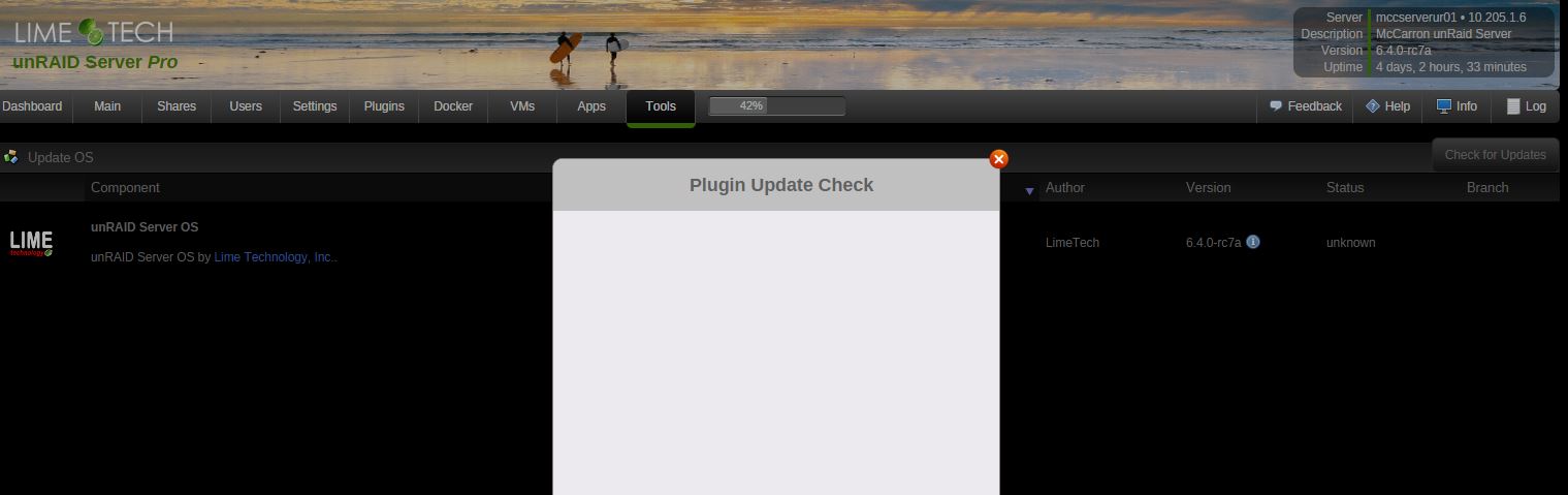

When I try to update Plugins or Update OS, nothing happens.

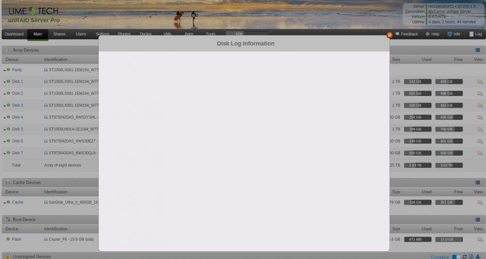

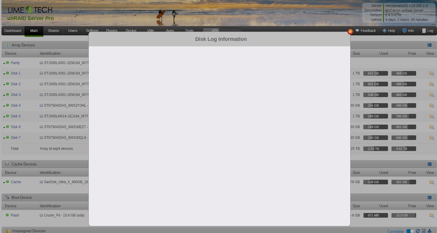

What ever is wrong also appears to effect the Disk log popup window.
