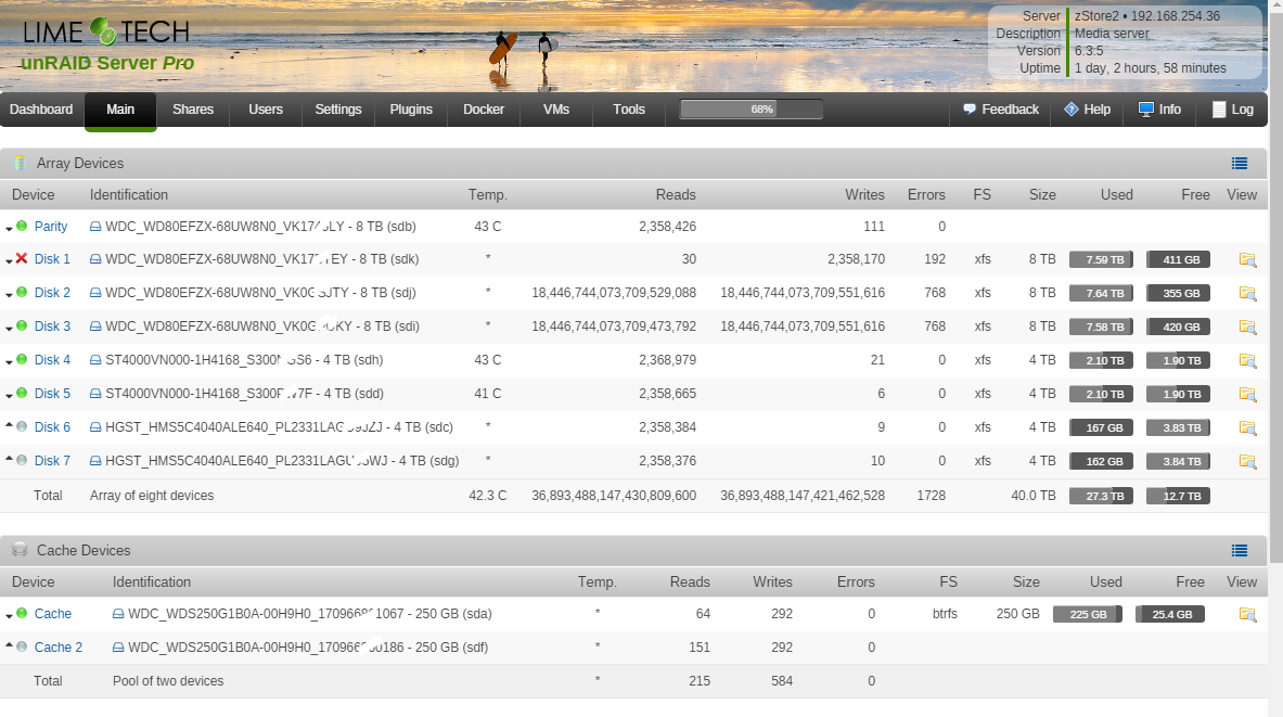

Mover running trying to cache 20TB on 250GB cache
Hi Support,
New weird behaviour. Was trying to work out why the cache was not being used for one of the shares yesterday when it is enabled (setting Yes) and set it to preferred to try it. Today I notice the array is accessing and some drive are up when it should be idle. After a brief freak out thinking a virus is wiping my data, it turns out it is the mover.
It is copying data off the share set to preferred and putting it on the cache drive. But the share is near 20TB and the cache is a pair of 250GB SSDs and they are now full, nearly 200GB or so is missing from the reported usage for the drives in the share and the SSD is full (760MB free).
I can't stop the array because mover disables that and it is still doing something, reading one of the data disks still.
I don't know if it is actually damaging array contents or not at this stage. It could be.

Moving data back has resulted in an error reported on disk1 again. The disk1 I replaced 3 days ago (new) for one that failed 2 months ago.
Been online successfully for a day only.
What is going on? Seeing log errors against allmost all drives. The only one taken offline is the disk1.
Is it power supply or controllers? How can I tell? I can't believe it is disk drives. There are 2 controllers in the machine. What the chance of both being faulty?
These are on the cache but no errors in the main page.

What is wrong with this rig? Should be drawing less power than the 4TB drives it had before. 8TB WD Reds I am having nothing but trouble with. What is this?
If I haven't lost data now it will be a miracle.

Am I screwed?
md1 is disk1, but I would use the server as little as possible until you replace the SAS2LP controllers, mvsas driver used by them was constantly crashing on your logs.
Controller purchased and on the whay but looks like 2 weeks minimum.
Miraculously, that folder has returned after the array went to sleep and woke up again having left it for a day almost.
How do I run the xfs_repair if the volume it needs to run on is synthetic but has to be dismounted to run the command? Would I have to resync the contents in the corrupted form first back onto a drive and then run it or can I address the synthesised content with the array in maintenance mode and repair it like that?
I have set the mover to 1 month schedule to stop it making more churn of this until I can get the replacement controller in place. Is there another way of stoping it from running?
Thanks for the assists all so far. Would never have worked out the controllers easily although I was suspicious from some of the problems experienced since moving to v6.
You can put the array into Maintenance mode and run the repair from there.   In fact Maintenance mode is always the recommended mode for running repairs.

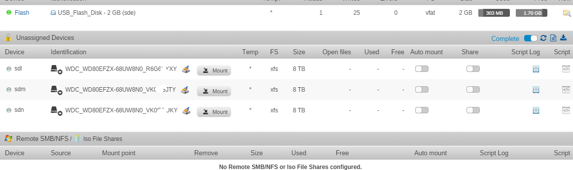

Well a few hours later, I come back to this disaster. What the hell is this? It did not do that many reads and writes. The worry though (appart from the obvious failed rebuild) is the errors column and for all the 8TB drives.
Disk 2 and Disk3 8TB drives are currently showing up as unassigned devices also.
Is this drivers? Firmware or some problem with large disks? Surely can't be all 3 drives.
Diagnostic output attached.zstore2-diagnostics-20170818-2249.zip
