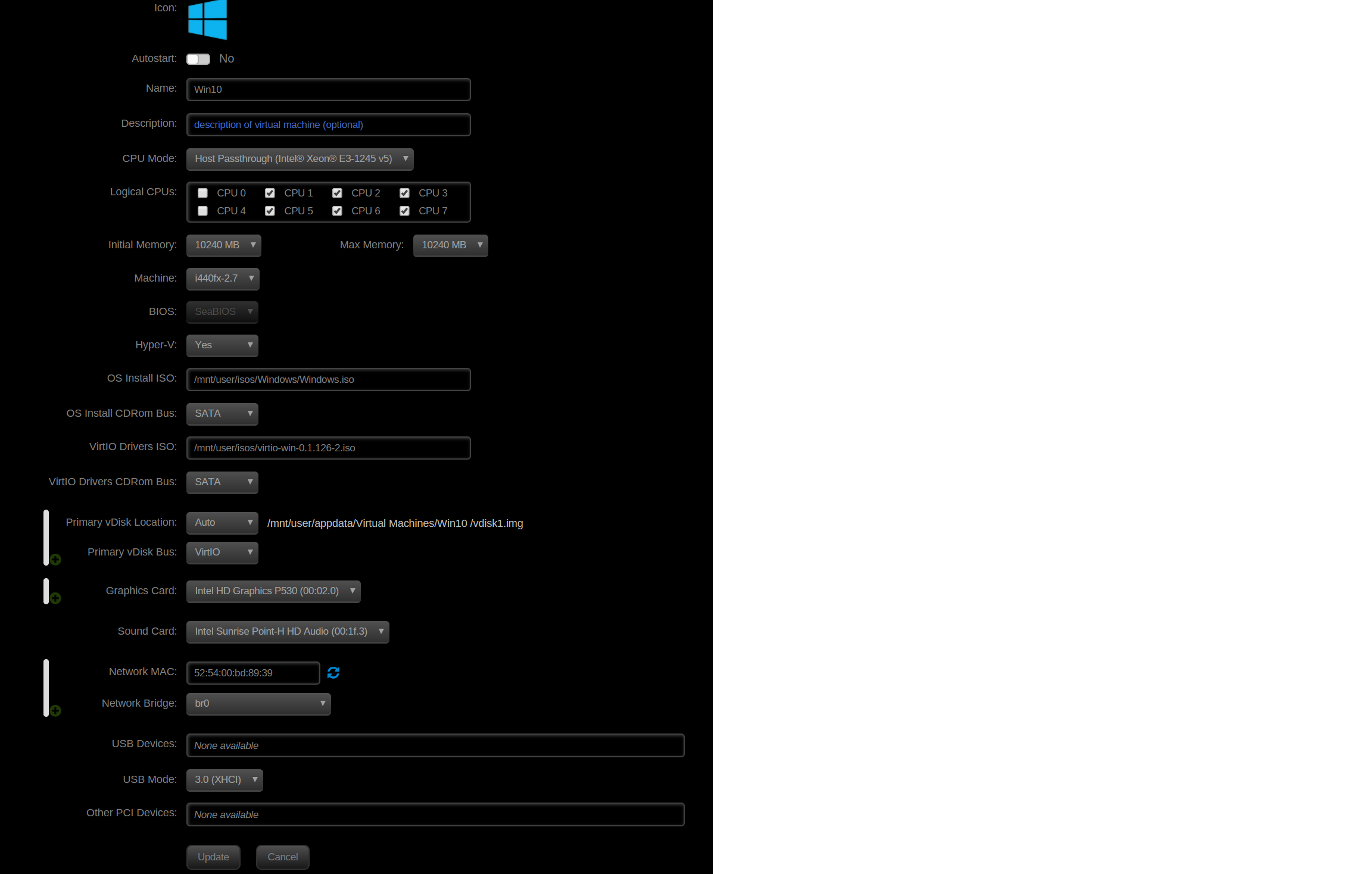

August 4, 20179 yr I have an i5-6400 & AsRock H170M pro4 and I'm trying to pass through the iGPU to Win10 for handbrake encoding (might try the docker, but want to see performance difference). My HD audio is in an IOMMU group with other devices: Quote IOMMU group 8 [8086:a144] 00:1f.0 ISA bridge: Intel Corporation Sunrise Point-H LPC Controller (rev 31) [8086:a121] 00:1f.2 Memory controller: Intel Corporation Sunrise Point-H PMC (rev 31) [8086:a170] 00:1f.3 Audio device: Intel Corporation Sunrise Point-H HD Audio (rev 31) [8086:a123] 00:1f.4 SMBus: Intel Corporation Sunrise Point-H SMBus (rev 31) I have set the ACS Override to Yes, as well as tried pci-stub in syslinux config: (I've rebooted multiple times with each syslinux change seperate - no change to the IOMMU Group). I've searched & searched, trying different solutions from as far back as 2015. Most of what I'm searching seems to have been included in the win10 template since problems have been posted. I just can't get any of the suggested fixes to affect my IOMMU groups. The xml references the correct PCI address for the audio device (00:1f.3) using the template. I've seen a mention of specifying address rather than ID for pci-stub, but no suggestion of syntax, so I haven't tried it. I've screwed up enough Linux systems to know that I need a tutorial...... default /syslinux/menu.c32 menu title Lime Technology, Inc. prompt 0 timeout 50 label unRAID OS kernel /bzimage append pcie_acs_override=downstream initrd=/bzroot label unRAID OS GUI Mode menu default kernel /bzimage append pcie_acs_override=downstream,id:8086:a170 pci-stub.ids=8086:a170 initrd=/bzroot,/bzroot-gui label unRAID OS Safe Mode (no plugins, no GUI) kernel /bzimage append pcie_acs_override=downstream initrd=/bzroot,/bzroot-gui label unRAID OS GUI Safe Mode (no plugins) kernel /bzimage append pcie_acs_override=downstream initrd=/bzroot,/bzroot-gui label Memtest86+ kernel /memtest (My server will only boot in GUI Mode, so I set it as default. I don't know what happened, it booted to regular mode the 1st time it booted, but now stops after loading bzroot, left for 30 minutes & no change. Started from scratch USB & still same behavior). USB Mouse & Keyboard pass through works fine. If I select the GPU & Audio to pass through (using the template) - I get an error & VM won't start (error states PCI device (00:1f.3) is in use, as expected). If I ONLY pass through the GPU, set sound card to 'none' - VM starts, but I get no video on monitor (HDMI -> VGA adapter or VGA) (monitor blanks from unRAID GUI at VM start). I can RDP in, and installed the Intel Drivers & it seems to work fine (handbrake detects quicksync), just no audio. Any suggestions? Not sure what I'm doing wrong.

August 6, 20179 yr ok so the integrated graphics have been set as primary boot device from the newly flashed asrock bios menu? have you tried using just hdmi out from the motherboard to hdmi tv/monitor? removing the vga adapter for testing? Does Unraid boot with my syslinux.cfg? What error does the VM template give when you select intel audio? (assuming unraid boots) I would get the VM working without VNC first then work on the audio. Edited August 6, 20179 yr by raidserver

August 6, 20179 yr Hey snidera its not so much change the IOMMU group, it can release the audio device ID, ours being 8086:a170. The hardware is part of the smbus which has x4 other devices within it so the line isolates the audio for passthrough. Like i say we have almost identical systems and being able to passthrough the whole CPU has worked great. Give it another shot without the RX460. I suppose you could get your encodes complete via RDP but having gpu/audio working has been fun with a few VM`s LibreElec/windows/linux mint. Once the VM starts with intel audio selected in the template you know you are golden It does everything i need apart from heavy gaming but i use desktop for that rather than put my gtx980 in the server. Edited August 6, 20179 yr by raidserver

August 7, 20179 yr No problem, now that the vm template saves and is working if you havent already gridrunner has an excellent two part video on Win 10 VM installs worth watching. He highlights everything needed for a successful Win 10 install. Like turning off hibernation and windows search function among others, just in case you may have missed something. Perhaps you have missed a redhat network driver or something. HERE When i first started making vms with this hardware i also had black screen when the vm tried to handoff the video signal, the fix was to make igpu primary gfx video output from bios not auto. This is also paramount when installing a separate gpu. Not realy sure what else i can say about the video other than check cables maybe try other spares. EDIT: i should say that the only successful vm template settings that worked are SEABIOS and i440fx-2.7 Edited August 7, 20179 yr by raidserver
