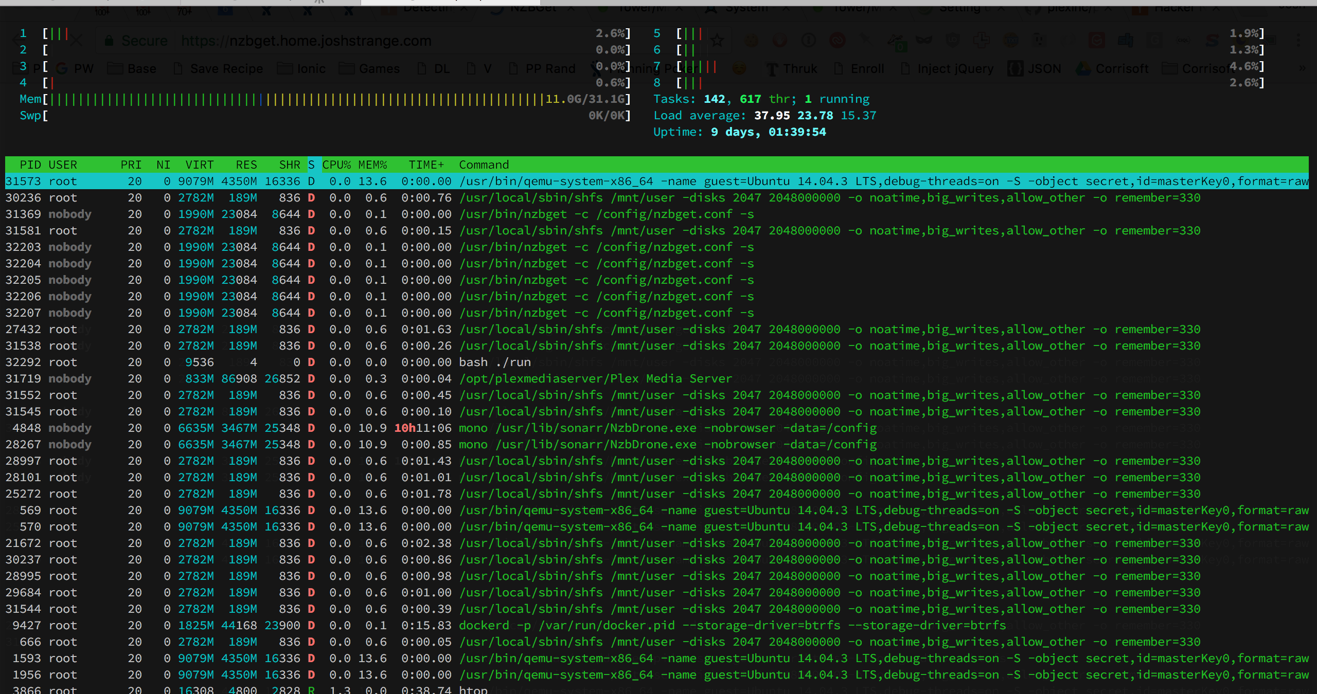

I've had this issue for a while and I'm about at my wits end. I'm tried a ton of different things and the problem persists. I first saw issues as my array started to fill up and when NZBGet would unpack a download the load average would spike as a ton of processes would enter state "D" uninterruptible sleep (See picture). It turns out my CPU is sitting there doing nothing, memory is fine, but load average will climb to 20, 30, 40+ and the web UI becomes unresponsive, "docker ps" won't complete, all docker images and VM's just lock and won't do anything.
