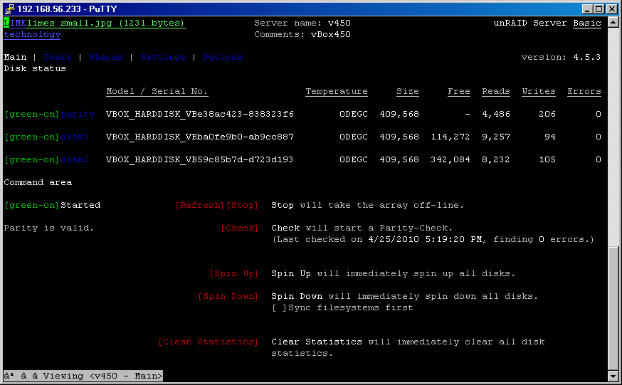

Text Web Browsers on the unRAID Console (Lynx, Links, w3m)
The unRAID's Management Utility on the server console with Lynx...
lynx http://localhost/main.htm

I just get "Wait..." when I do lynx localhost
probably because I have set a root password?
Strange.. if I do lynx localhost:8080 i get to the unmenu page just fine..
anyway, tried lynx http://192.168.234.10 and  it asks for the user and password.. and then I'm back to the "Wait..." screen (I waited for 1/2 hour.. no change)
Honestly, I can't advise you.  I just discovered Lynx myself, and am playing with it.
I'm sure there must be more text web browsers that we can try on the console.

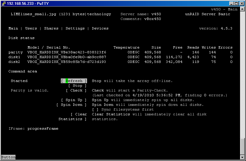

Same thing but now with Links...
links http://localhost/main.htm

As an FYI, Lynx is incapable of being used to setup or make changes to the Devices tab of unRAID. It doesn't trigger the auto submit (javascript?) after a change is done to any of the combo-box controls.

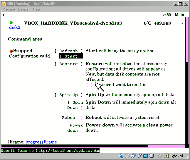

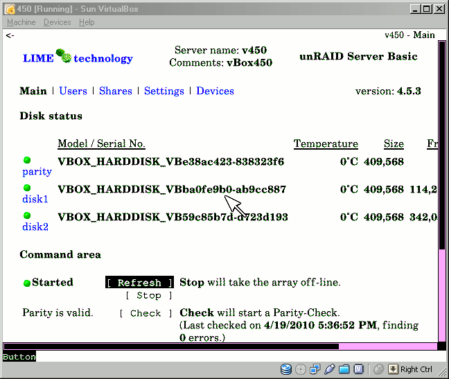

And here's Links again but with "-g" option...
links -g -mode 640x480x16 http://localhost/main.htm
Now we're getting somewhere!  :)
As BRiT said, it doesn't properly refresh emhttp's submit buttons.  You can somewhat work around that: after a submit button, go back to "main.htm" with the left arrow <-- and refresh the page with Ctrl-r.  I was able to stop/start the array that way, even ran a parity check.

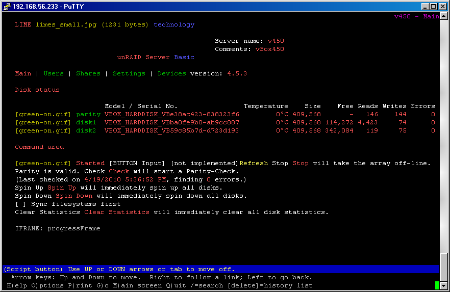

And now the same thing, but with w3m.  (w3m requires libgc)
w3m localhost/main.htm
