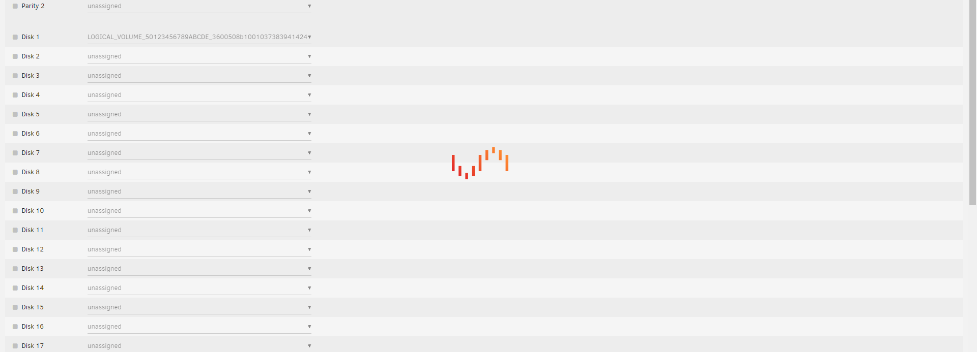

I have a hp dl380 g6 and in trying to setup unpaid and I'm having some issues I've been trying to get unraid to detect my SATA SSD I've put in but it doesn't detect it at all I've made a raid 0 array on it's own but no luck Can you help me?

I'm using a p420i as my raid controller with my SATA SSD in raid 0.

When I put the disk in raid 0 unraid still doesnt reconise it.
I don’t know if it’s a problem with the ssd not having hp firmware on it perhaps ? Has anyone else had much luck using non HP drives in dl380 g6/g7 etc ?
The fact that the controller is seeing the drive kind of makes me think it’s an issue with unraid, I’ve not got any other drives and no ssd’s I can try it with :(

So after many hours of me trying to get unraid to detect my drive i've decided to buy a new raid card, which one should I get. ive been told that the H220 works fine with unraid.
Recently I had a 600gb HP SAS drive fail on me, so I have bought a few replacements (found 3 for £30 on ebay, supposedly in good working condition), I shut down the server, replaced the drives and booted it back up.
The p410i detected the replaced drive so I didn't have to re-create the raid0 volume, and went on to boot into unraid. I stopped the array, selected the newly installed drive and then clicked start array... unraid crashed and the drive, which was previously fine and gave no smart warnings, then had it's fault light solid, suggesting it had failed and also when I rebooted the server I was given a SMART warning saying that imminent failure was detected...?
Am I missing something with how I can replace the failed drive ?

You could try another disk to see if you just got a bad one. I have no guidance because I don't use the raid controller with disks in raid 0 because weird things like this can happen.
Have tried another disk and this one seems to be okay.
Drive is currently being rebuilt at 93~MB/sec, I did manage to get the previous drive to start rebuilding but it was writing at 300~KB/sec so it very well could of been a bad drive.
I'm definitely going to look to buy a HBA at the end of the month. Thankfully I've currently only got 474gb total in the array so I can move that all to a portable hard drive I have to switch all the drives over to a HBA.
