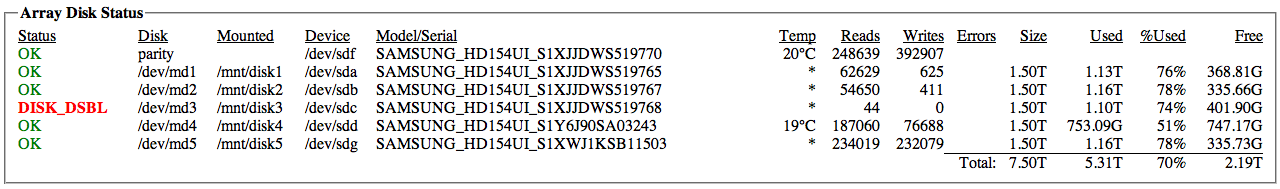

A few months ago one of the hdds in the array failed quite obviously with loud noises and lots of SMART errors (and had it replaced). A few days ago I noticed a
DISK_DSBL
next to one of the hard drives and a blinking orange instead of a nice green status bubble (see attachment).
I performed a SMART-test but I doesn't show any errors.
Any ideas on what's causing this problem? Thanks!

That smart test shows errors and it shows that some short tests never completed.
There is no long test either.

Do a short test on an idle system. It takes about 2 minutes.
Do a long test on an idle system overnight. It takes a little over 200 minutes (I believe).
That disk has some bad sectors reallocated. Servo seek failures reported as well.
I'd make sure you have a copy of the drives data as well as following Weebos advice.
