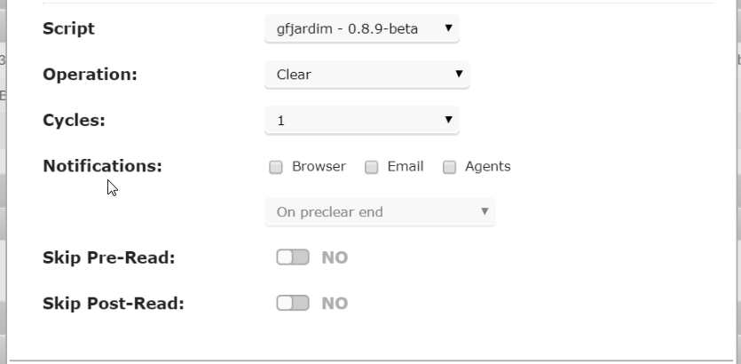

Sorry I should have posted another update. Once I got the controller card replaced I used the following settings and the preclear completed successfully. I am ordering another drive and will preclear it when it arrives and let you know how it turns out.

As I mentioned earlier, once I adjusted my settings as seen in the screenshot I no longer had the error. But all my drives are connected via SATA and not USB.
