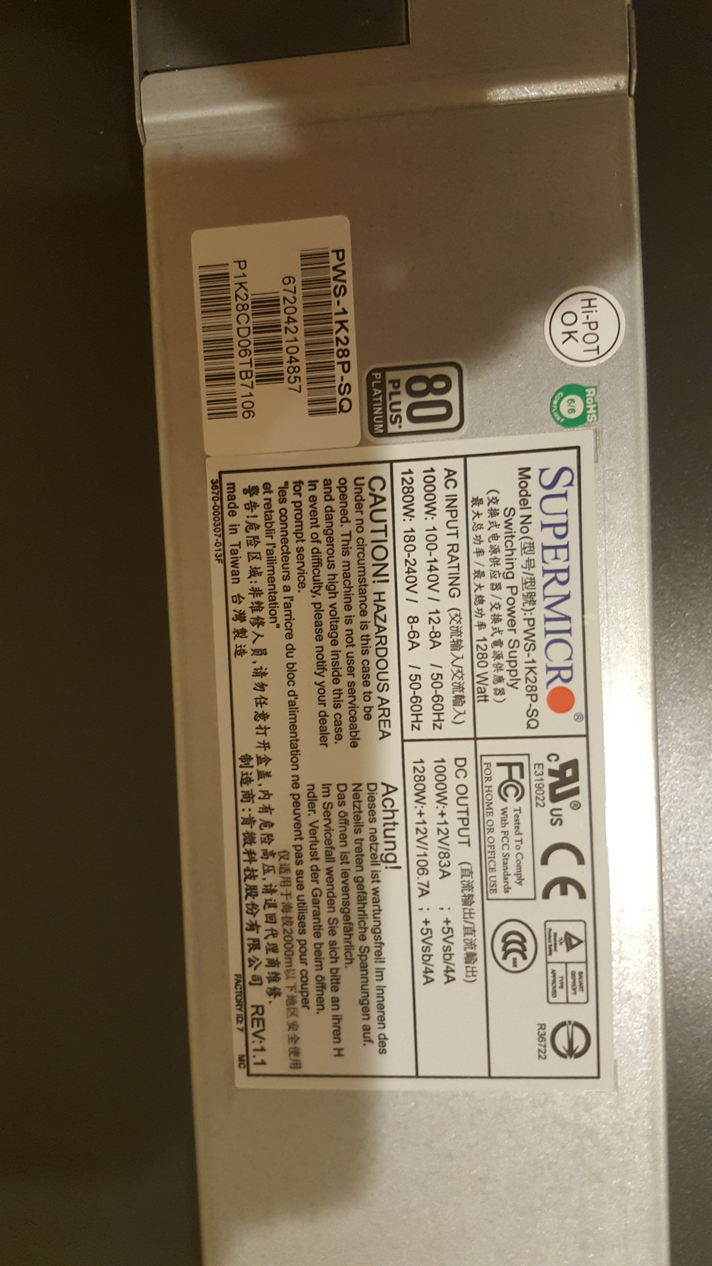

I'm building mine with a SuperMicro 3u case from ebay that came with two SuperMicro 1280 watt "Super Quiet" PSUs.  They are whisper quiet, but no idea why the original owner put them in the case with seven other weed wackers.  I only need one, and it looks like they go for $110 on ebay, I would let it go to somebody here for $90.

I just got my case and @ubergeek the psu aren't too loud i ordered 5 80mm noctua to see what temps and sound is like. Hoping its good if not i might look at the stock quieter fans. I keep hearing good things about super quiet psu from them and would be interested in seeing a video or hearing them before dropping all that money. I need at the very minimum between 900-1000 Watts as i plan to run vms with a gtx 1080 or 1070 to stick in the 900 watt range. @btrcp2000 are you selling both or just one i might be interested in picking them up. Thanks once again for all the input.
Just selling the one, as I am using the other.  We would need to address shipping as I neglected to think of that. PM me if still interested.
