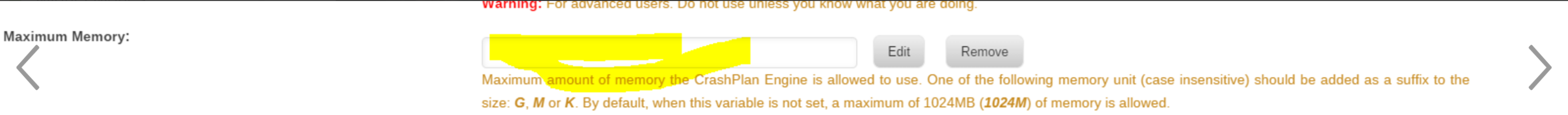

I'm not a Linux expert, so hoping to ave some guidance in what to type in to the CrashPlan/Code42 for small business docker to increase the Ram to 4gb. The wording doesn't tell me (as I'm a newby) what I need to type to field to increase RAM to 4Gb.. any guidance appreciated please?
CRASHPLAN_SRV_MAX_MEM Maximum amount of memory the CrashPlan Engine is allowed to use. One of the following memory unit (case insensitive) should be added as a suffix to the size: G, M or K. By default, when this variable is not set, a maximum of 1024MB (1024M) of memory is allowed.
If you want to increase to 4GB, just put 4G.

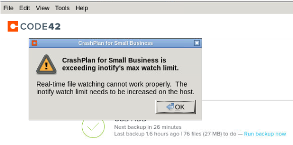

I did a quick search of the forum for this, has any one had this occur? I don't see an advanced parameter that can be updated like the memory allocation one.
For searching purposes, "CrashPlan for Small Business is exceeding inotify's max watch limit." and "Real-time file watching cannot work properly. The inotify watch limit needs to be increased on the host."
Edited by geonerdist
This can't be set from the container's settings because the issue is on the host (not the container).
In other words, you need to increase the limit of unRAID.  You can use the "Tips and Tweaks" plugin to change the value.

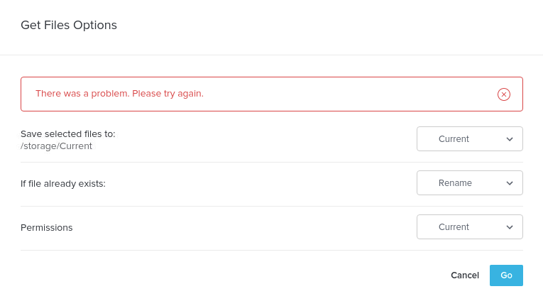

Hi!
I'm having a problem restoring files.
When I select original location, restoring completes, but files are not there, if I try to select manually specific location I'm getting this error:
By default, the /storage mapping is read-only.  Edit the container settings and change the permission to read/write.
I'm sorry, I'm not very fluent with container work. I don't see a parameter in readme ther eis "unmask" and there is also information about data volumes.
Do I need to put in extra parameter or change the unmask value?
In unRAID, go into container settings (click the container name from the Docker tab).  Then switch to Advanced View (toggle at the upper right).  You will now have an Edit button beside the "Storage" setting.  From there you can change the Access Mode to Read/Write.
Neither; in the container settings page, click "Edit" next to the storage path mapping, and a modal popups; It has a few options, but you'll just change "Access Mode" off of read-only.
