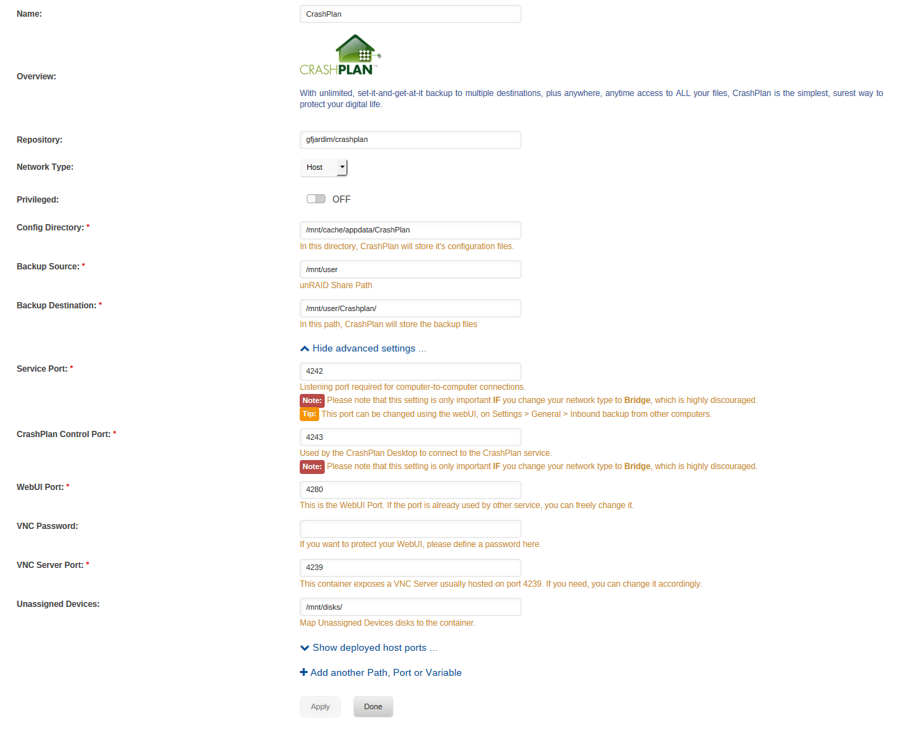

Hi, I'm migrating from Crashplan Home and want to make sure I do it correctly.
I'm currently using gfjardim Crashplan Docker.
I backup to Crashplan Cloud and I also backup to a local unassigned unRAID USB device.
Does this docker support backing up to an unRAID unassigned device?
If so do I need to setup the path so the docker will list it as a backup location?
I've attached a sceenshot of my current docker settings.

Yes, CrashPlan PRO can backup to a local destination.  However, I don't know if it will be able to take over your existing destination.  It will work for sure for the cloud, but I can't confirm for a local destination as I never tried.
I don't mind starting fresh locally.
What steps do I need to do to have the unassigned device show as a destination in the Pro docker?
In my current Docker I think I had to add a path so it could be seen.
Yes, you need to add a "Path", where the host side is set to "/mnt/disks" and the container side to "/unassigned" (or anything you want).  Make sure the access mode is set to "RW/Slave".
Inside the container, you will be able to find your USB drive under "/unassigned".
