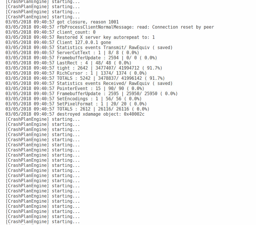

I'm hoping that you can help. I've been going through this great topic and trying various things to fix this. I installed CrashPlanPRO as a migration from CrashPlan. I finally got my first backup to work and when I woke up I saw a bunch of errors in the docker for having run out of memory. I edited the memory for a maximum of 3072, restarted and (not sure if any of this is related). Crashplan won't fully start up. The logs show a constant "CrashPlanEngine is starting". I saw others were having this issue so I ran the command I saw there:
"docker exec CrashPlanPRO /usr/glibc-compat/sbin/ldconfig"
it ran once I started the docker with no errors, but didn't seem to fix the issue. I restarted the docker a few times. I increased the memory, then removed the maximum memory as well, all to no avail.
Here is a sample of my log file:
Is there something I'm doing wrong?
Thanks so much for your help and this docker.
You probably made a typo in the max memory value.  It should be 3072M, not 3072.
It was as simple as that. Thanks so much!
