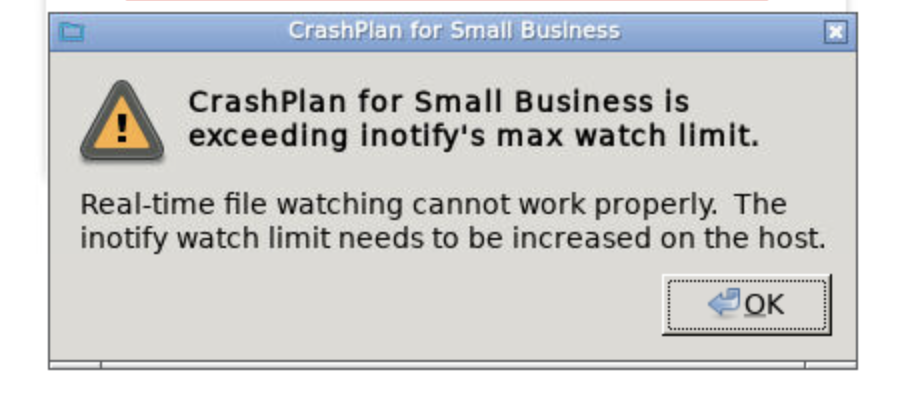

My Crashplan has stopped working, tried update, but is is still trying to and failing to update in the app.
EDIT: I Think I fixed it by these two steps:
- Increesed "inotify"
https://forums.unraid.net/topic/59647-support-djoss-crashplan-pro-aka-crashplan-for-small-business/page/11/?tab=comments#comment-614099
- Increesed "docker image"
https://forums.unraid.net/topic/40376-no-space-left-on-device-error/
Edited by Flemming
