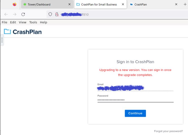

Howdy folks, Since updating to 6.12 from 6.11 I've been having the same issue as @Gico:  I can't login the web-ui saying Crashplan is "upgrading to a new version"
There is a new version of CrashPlan available.   I'm working on this and a new image will be released soon.
However, I'm not sure why this prevent you from accessing the interface.  Do you usually have to enter your username/password every time you access the interface ?
Thanks Djoss. Yes, I have to enter password every time. My user name already exists in the web-ui.
Thanks for the quick turn-around Djoss.
Alas no, Docker's WebGui Still shows the "upgrading to new version" message after entering login credentials into Web Gui's Interface.
Edit after 3 hours:
Docker's WebGui still throws the "upgrading to new version" issue
Docker's WebGui shows version 11.1.1.2
CP's Website Portal indicates Computer is Online & Backup is 100%
CP's Website Portal shows version 11.1.1.2
Edited by landS
Having a message about the upgrade failure is expected.  However, it should not re-appear after you close it.

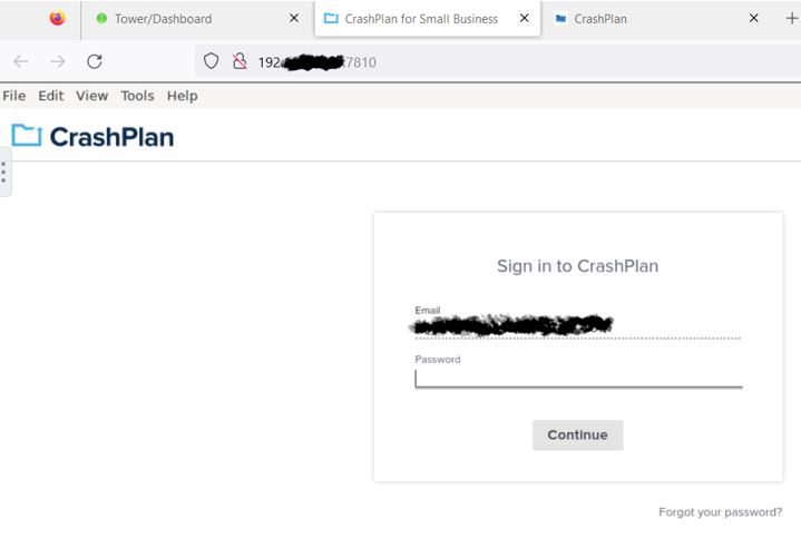

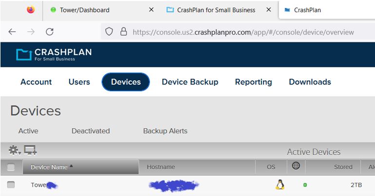

Alas, this appears to be a troublesome beast.
I updated from v6.12.1 to 6.12.2.
In the Crashplan Docker’s WebUi it shows in the left hand popout:
     Crashplan v11.1.1 & Docker Image v23.06.2
Image 1 is what the Crashplan WebUi looks like when I start the docker.
Image 2 is what the Crashplan WebUi looks like after I insert the password and click Continue.  This is where the message pops up.  If I close the WebUi and open it up the problem persists.
Image 3 is what Crashplan’s Website looks like.  The only item of note here is that the computer shows as online.

I’ll wait a bit and hopefully this gets resolved.
Thanks! Things are back to normal and I was able to update. Now CrashPlan Pro keeps crashing after some time and I can’t figure out why. I see nothing in the system logs, but when I hopped into the appdata folder it looks like I had issues I wasn’t aware of. The damn thing appears to just exit and then start up again just about an hour apart. Now it just stops.
Any ideas on where to look to fix this? Honestly thought this thing was running smoothly cause I never saw any errors.
I can see in the history when it just stops, both in the UI and in the log files. I’m not sure where else to look for errors though. The UI error log is full of errors, but it seems to working so I have no idea if that has anything to do with it.
here it is just in case:
