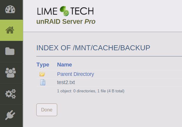

After moving this single file, My Backup Share is now showing on the cache drive with this file in it.
That log shows that it first trying a simple rename and since that works at the Linux level it stops there.   However the rename has left it on the same physical device (the cache drive) and thus the symptoms you see.    You need the move to be executed as a copy/delete process for the User Share settings to have an affect.
