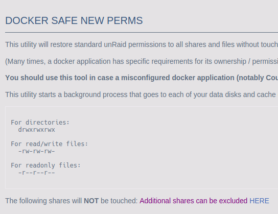

August 26, 20178 yr This utility will restore standard unRaid permissions to all shares and files without touching any of the APPDATA shares for docker applications. (Many times, a docker application has specific requirements for its ownership / permissions on the files contained within its appdata, and the standard New Permissions tool will change these, possibly rendering the docker application inoperable.) You should use this tool in case a misconfigured docker application (notably CouchPotato or Sonarr / SickBeard) has written media files to your array with the wrong permissions, and you find yourself unable to modify / delete those files.
