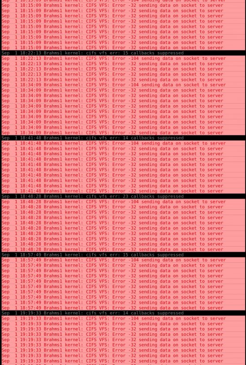

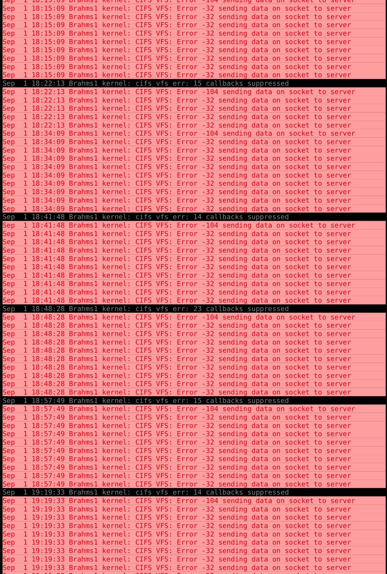

Also, duplicati is causing the following errors in my syslog:
Lots of those, using the same path/credentials that crash plan and cloudberry use, but without errors. I'm believe this is also causing slowdowns but unsure why it is occurring only with duplicati.
