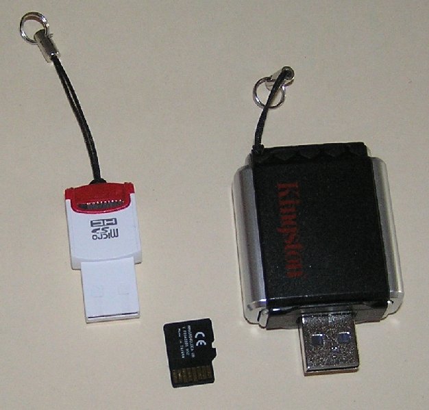

It works!  Whoo!  No problems whatsoever, it worked just like a standard flash drive would.  unRAID recognizes it, and my mobo also boots from it no problem.
This thing is so tiny, I think it might even be safe enough to keep plugged into the front USB port on a case.  I probably still won't do that, though, since I like to plug my keyboard into the front USB port if I ever need it.
Behold, the tiny-ness:

I bought these two flash card readers, tested with two different flash chips in each.  Both maintain their GUID.
http://accessories.dell.com/sna/products/Flash_Memory_Cards/productdetail.aspx?c=us&l=en&s=dhs&cs=19&sku=A3205741
http://www.newegg.com/Product/Product.aspx?Item=N82E16820208461
The bigger one has slots for two different sizes of flash memory.  The smaller only the smallest size.
After having experimented with these two readers for some time I've decided to start using one for my unRAID boot flash drive.
I picked the bigger of the two because for some reason I think it's sturdier but I might be imagining that.  It's sold as MobileLiteG2 and I got it for $7.  It has two slots, one fits a microSD and the other fits a full sized SD.
I stuck a microSD into it and booted but there was some type of problem.  Some, but not all, of the boot messages indicated a missing partition.  I think it's because of the two chip slots, the microSD is number 2.  So I put the microSD into a full sized SD adapter and stuck it into the MobileLiteG2 and booted again.  This time all went well and it booted without complaints.
Ok, this particular flash reader isn't exactly tiny but it's not fragile and the chip can be replaced with another simply by copying the contents to another.  While it's true that the reader itself could break eventually it's more likely the flash chip will just wear out.

I got two of those microSD but they actually have the same serial numbers 090C-6200-5678-901234567890 and Tom saw that the GUID looked strange and questioned them - with good reason.  Don't think the Kingston model will work and probably not the others as well but don't know.  I am going back to my original plan and using my Lextor flash drives.  Anybody want the two Kingston's I bought?
I recently bought this for my digital camera, then realize I probably won't need it since I bought an Eye-Fi.  Could I use the MicroSD card through the USB adapter as my primary unRAID boot drive?  Will unRAID be able to tell that it isn't a standard USB Flash Drive?  If there is too much hassle involved in making this work, then I'll just drop another $10 on a standard USB Flash Drive.
By the way, if this works it will be used to test out my new 20 drive Norco 4220-based build with unRAID basic.  If that all goes well, then I'll transfer my unRAID pro flash drive from my current server to this new one.
What Kingstons did you buy?  And have you bothered to check them at all?
Yes I installed them both in my server.  They both have the same ID above.  Also I bought TWO of the same model in Rajahal post basically this http://www.newegg.com/Product/Product.aspx?Item=N82E16820134990
