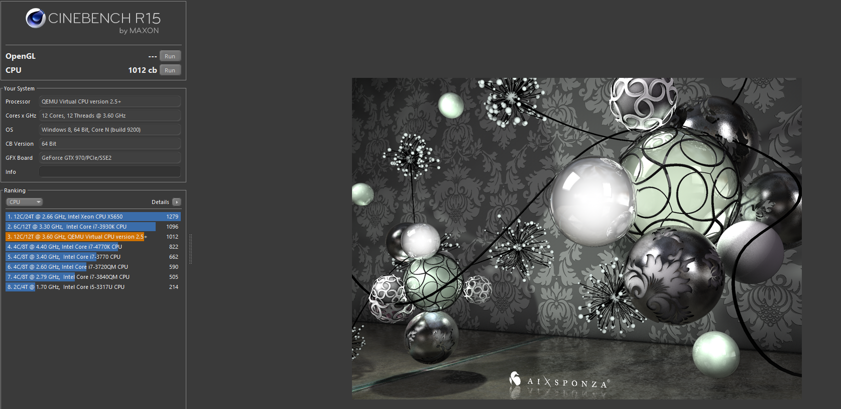

Cinebench 15

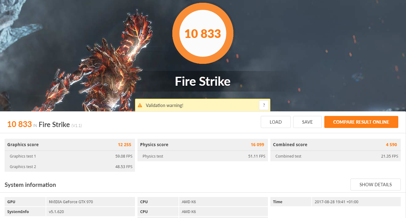

Firestrike (normal)
firestrike-npt-off-nvidia-allcores-3.6.thumb.PNG.cf682dd88f0cf1ded61ac820368488fb.PNG

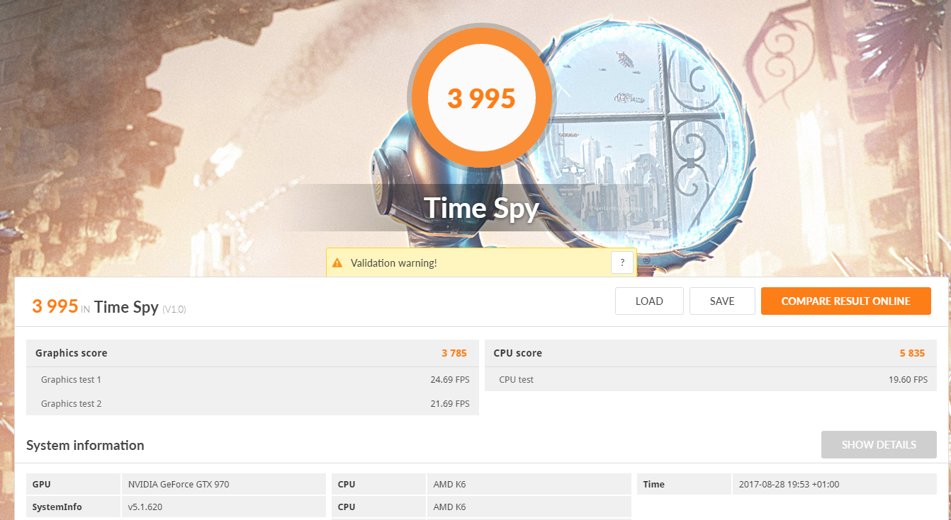

Timespy

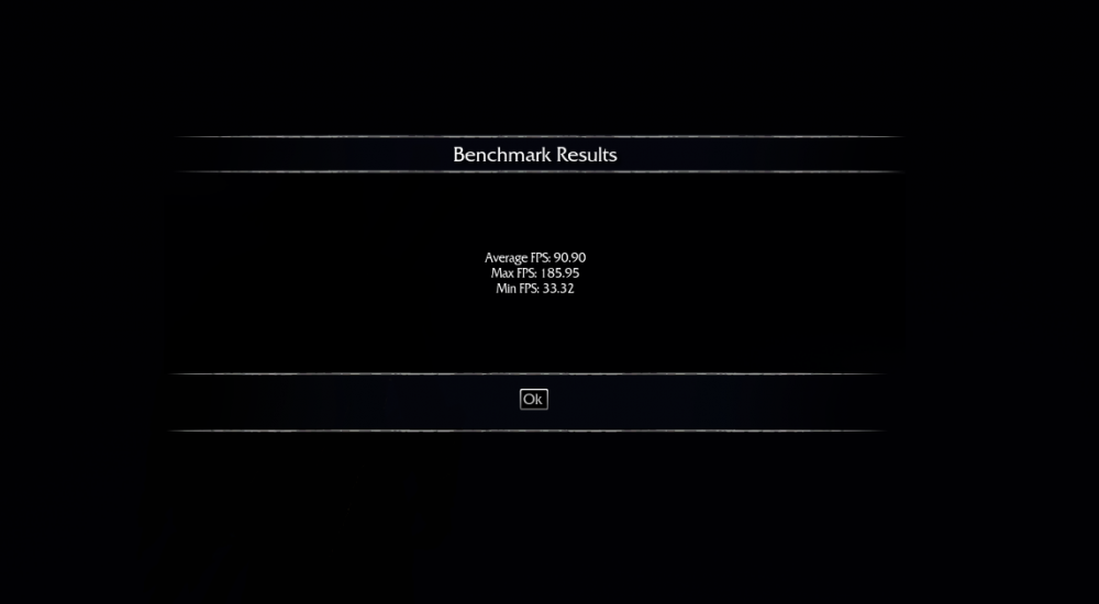

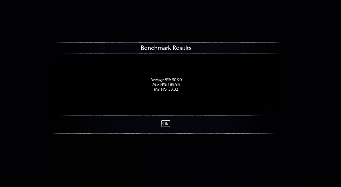

Shadow of Mordor (1920x1080 Ultra settings)
shadowofmordor-npt-off-nvidia-allcore-3.6.thumb.PNG.8b5888e4dd9fe4264343290b27c8717e.PNG

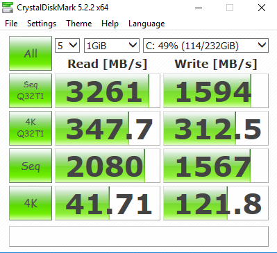

Crystal Disk Mark
