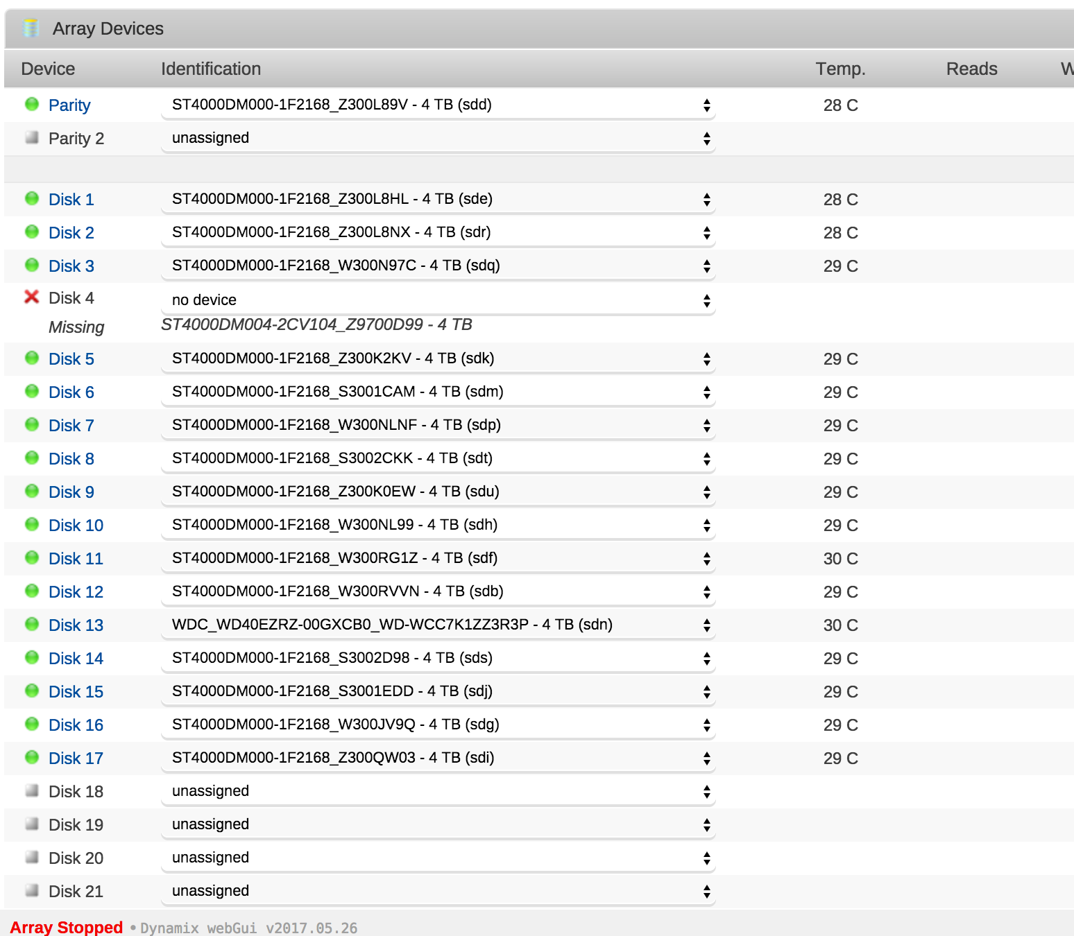

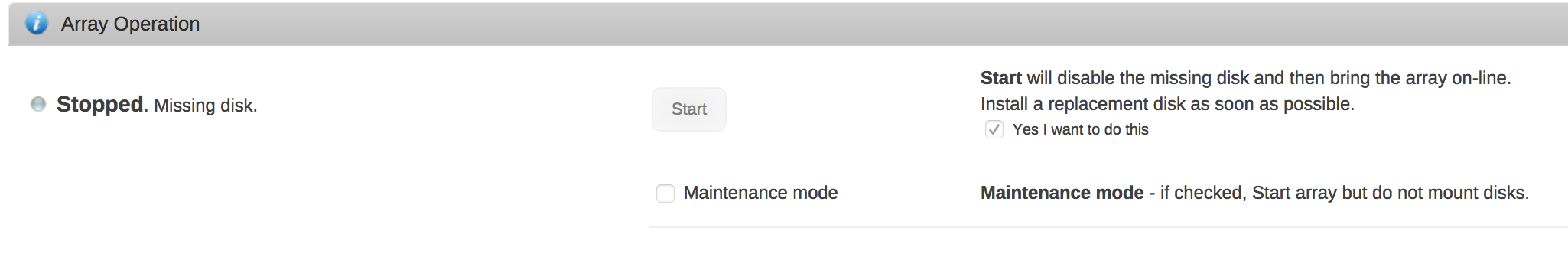

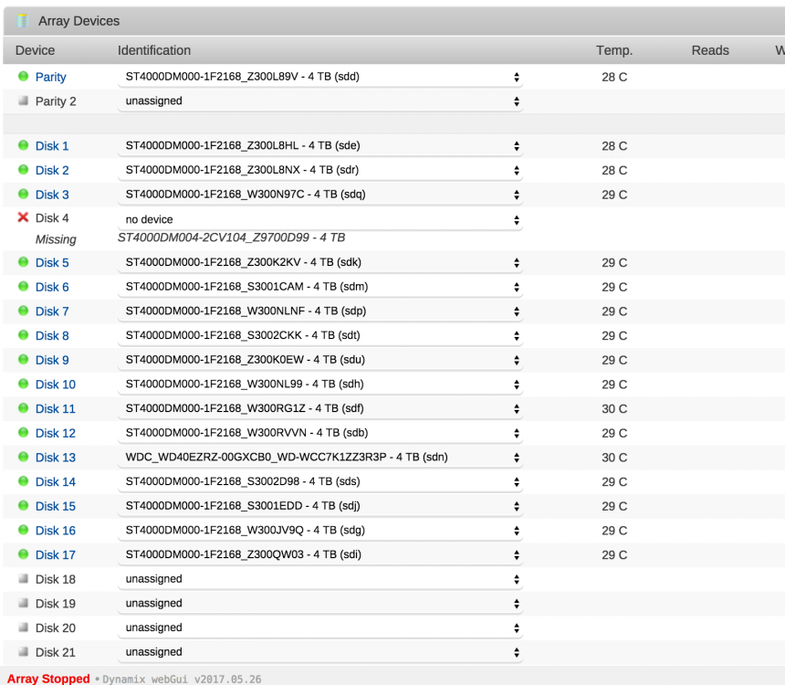

it happens at step 6.  after i unassign 4 in step 5 it says missing disk, check here to start array with missing disk, insert a replacement asap.  then when i start it it just comes up valid with no disk 4 instead of in a degraded state with an emulated disk

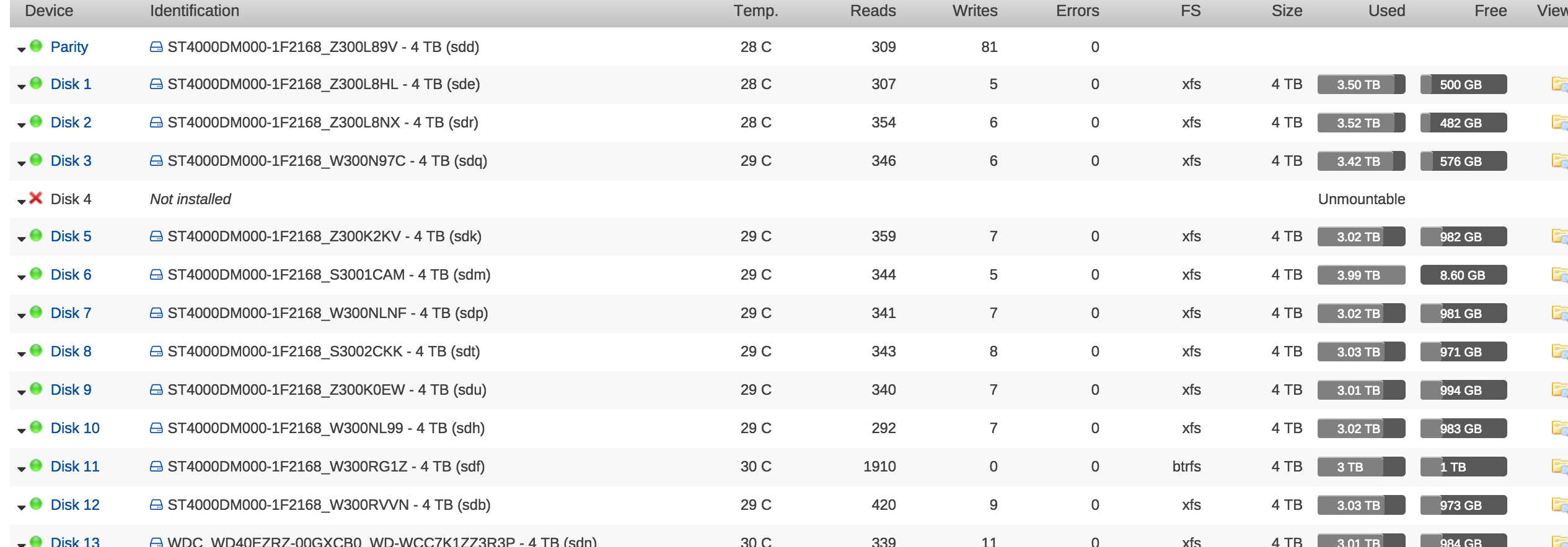

This is what happens
Ok, it's working, you have the emulated disk, disk4 is unmountable and that is expected since it already was before, now try running xfs_repair on it.
