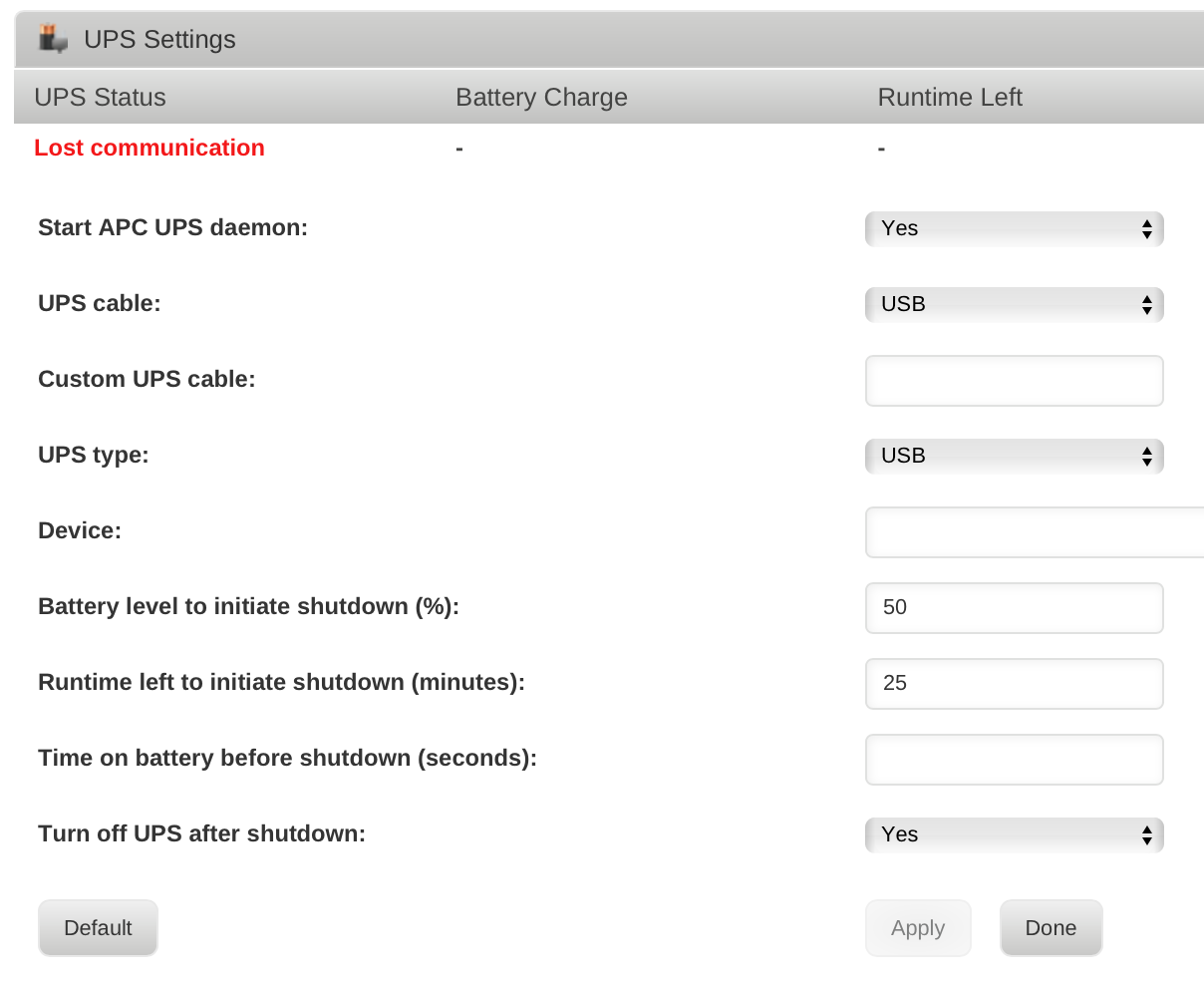

Unfortunately I don't see an option to change anything regarding the "Turn off UPS after shutdown" option. (I'm no longer in the office and detached the UPS for now)

Ok, I'm at the UPS now and did some research. You're right in that unRAID doesn't control the delay. This "Turn off UPS after shutdown" functionality doesn't work with Cyberpower UPS and should be set to "NO" or you will experience behaviour such as the scheduled hard shutdowns I experienced.
There's also no way to change the default 1 hour shutdown delay/schedule, not even in the Windows software or unRAID's apctest. APC units default to 90 seconds. I'm going to do some more research on this considering the poster in the freeNAS forum seems to be able to control this via USB.
