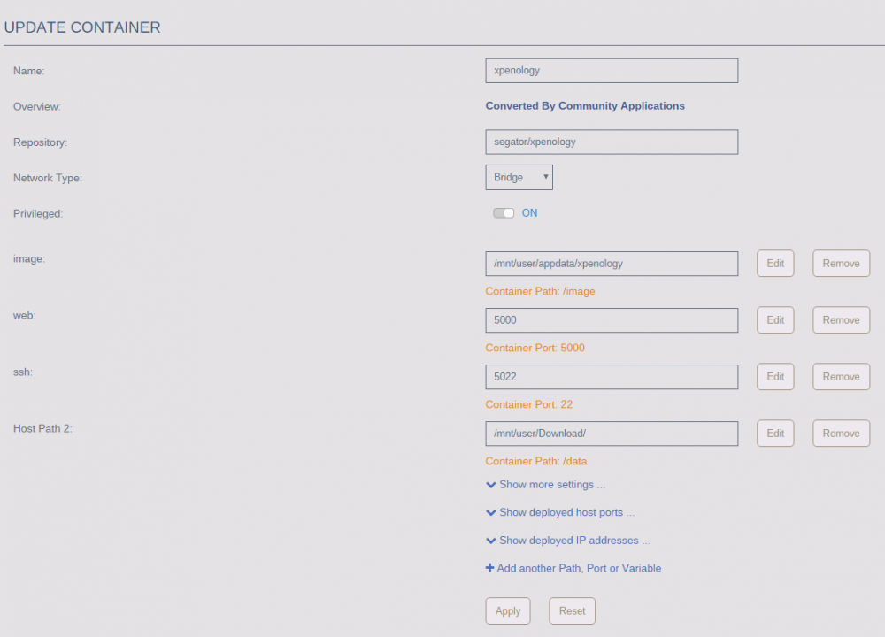

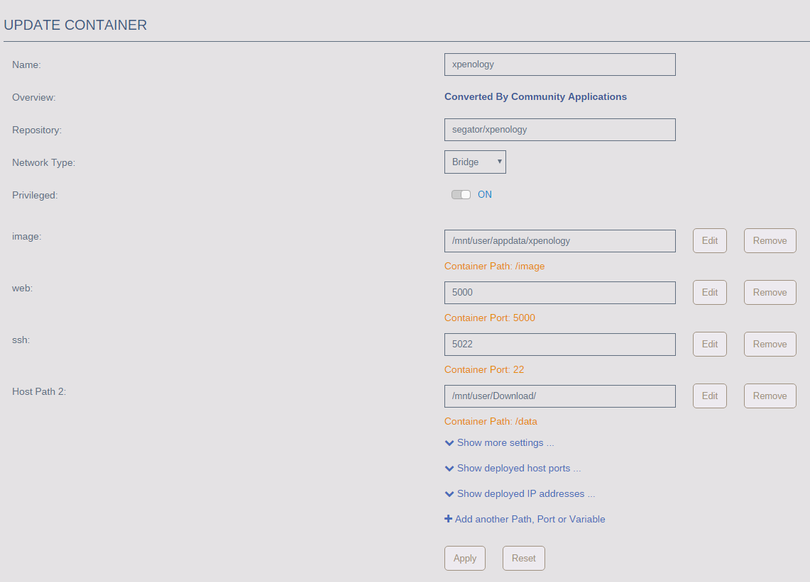

Can't get it work, nothing happens when i start it. Some logs where everything seems normal.

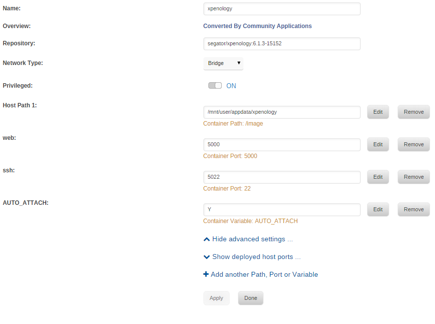

On 12/4/2017 at 10:20 AM, revilo951 said:
I'm on 6.3.5, and I'm getting this error when I try and start the container:
INFO: KVM acceleration enabled
ERROR: AUTO_ATTACH incorrect or undefined. It must be one of [Yy1Nn0]
@kabloomy posted this, and it seems to work for me
Add an AUTO_ATTACH variable and set it to Y.
The attached config worked for me. Notice the repository is not as per docker hub, it's:
segator/xpenology:6.1.3-15152
Docker offers an upgraded container that doesn't appear to do anything (?) but attempting to upgrade did reset some settings within the xpenology instance. Does this imply that not all config is stored in the single volume (image)? That might need fixing.
I added a raid group and then a volume (basic, btrfs) from within storage manager.
