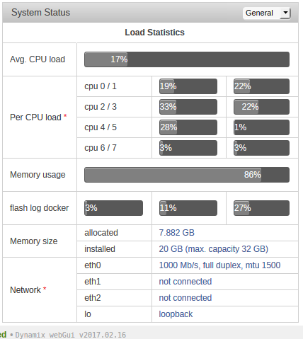

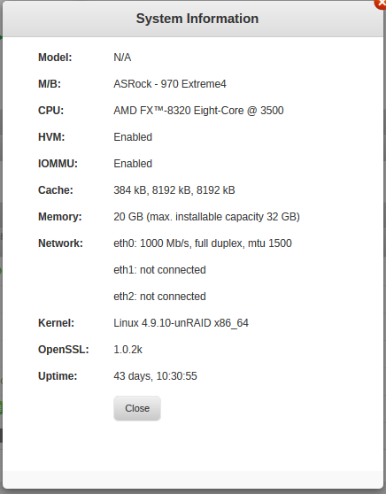

hi guys, i have the same issue, not sure if the above solved the problem, but here are my specs
unraid 6.3.2
 free
              total        used        free      shared  buff/cache   available
Mem:        8071464     5950368     1177376      504988      943720     1111740
Swap:             0           0           0
 dmidecode -t 17

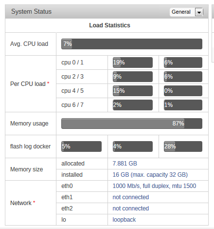

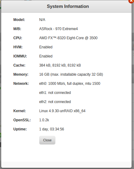

i did some testing moving my stick around.
i had orginally installed 2 x 8GB + 1 x 4GB sticks of ram.
i removed the 4GB of ram and just left the 2 x 8GB that are the same brand of memory.  they are both in the blue slots as for some reason one of the two white slots isnt reading one of the sticks.
i also updated unraid to 6.3.5 to make sure it's at it's latest version.
also updated the plugin  dynamix webgui to 20170526 version.
still having issues, below are my spec and updated screen shots showing my issue,
 as well as the free and dmidecode -t 17

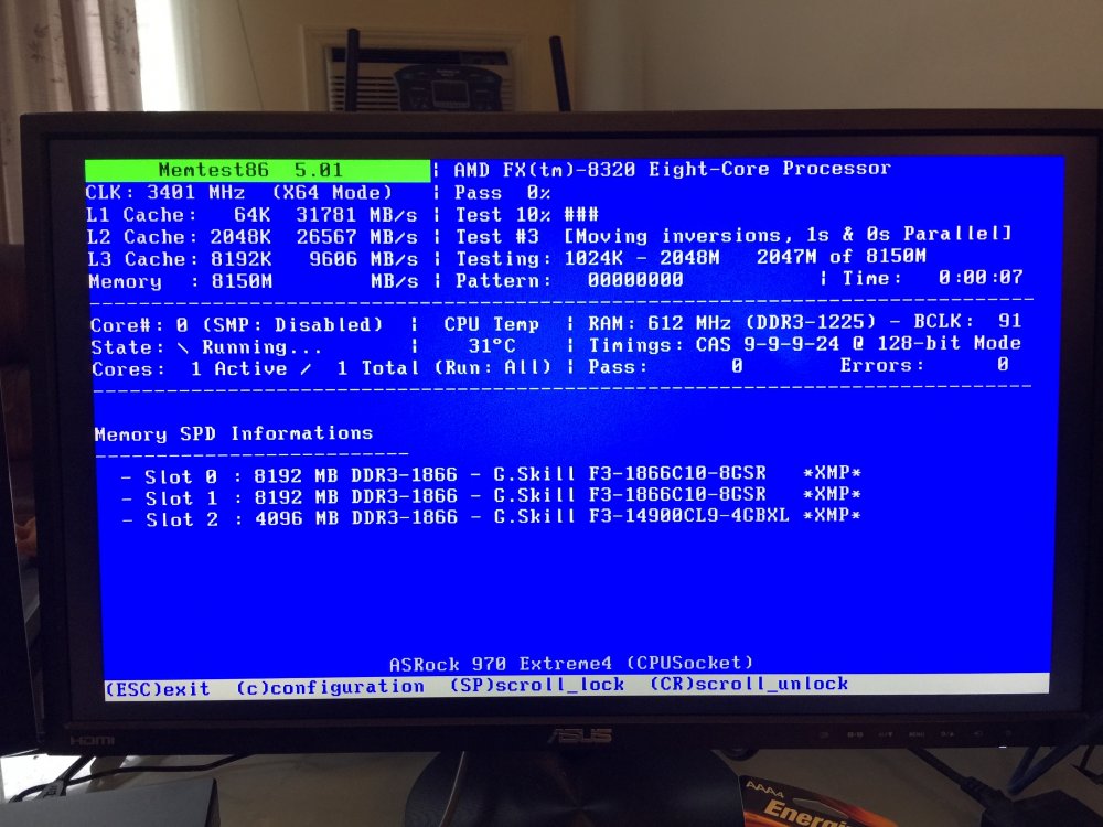

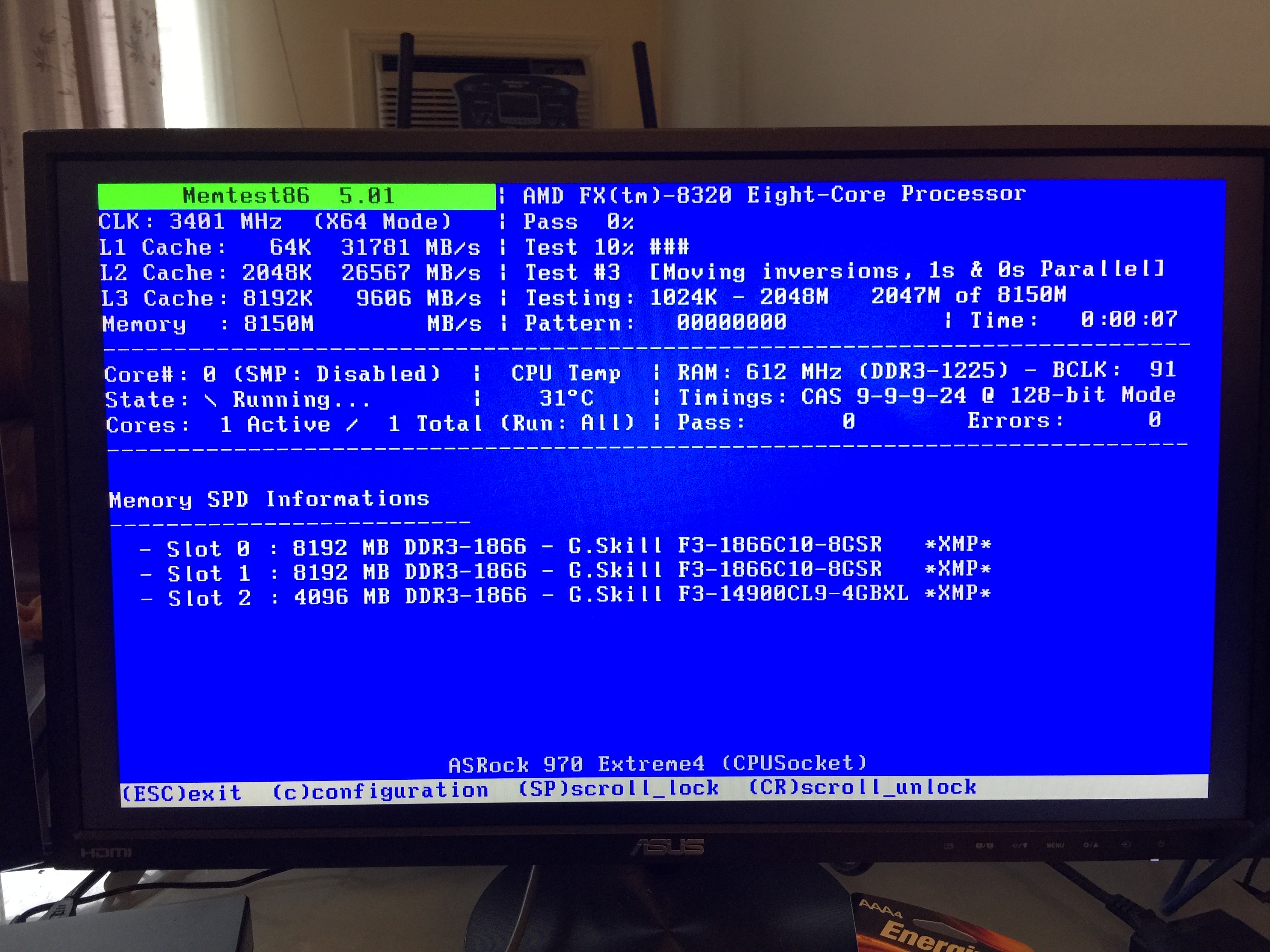

also i'm  attaching the memtest start up so you can see that the motherboard is well recognizing the 2 sticks.
note, i dont have any onboard video on my bios either.
hope someone can help, i'm going crazy trying to find answers... i see a lot of questions about this, but not a solid answer.
is this an issue with unraid??
