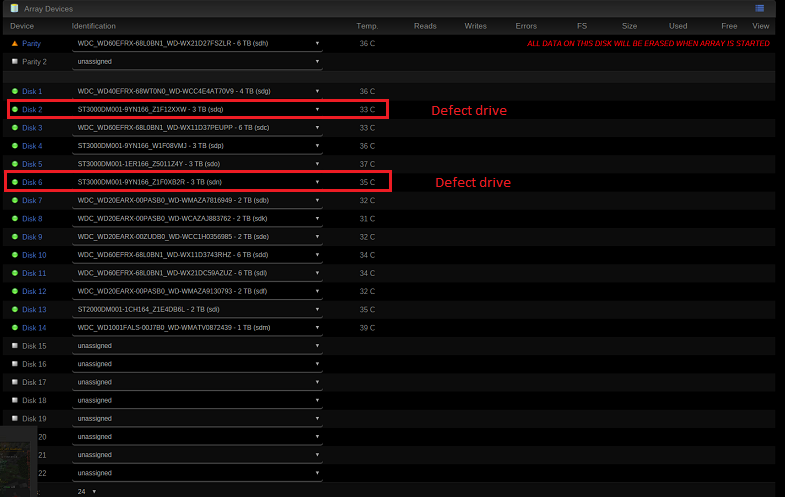

Hi, im new to unraid i have a big problem and i dont know what to do, sry for my english this is not my mother thong
I have finished the migration of my data to my new array. I added a parity disk and started the process, the problem is that there seems to be 2 defective disks and the parity would take 2356 days to complete ... I would like to copy the data from my 2  defective drives and removed them from the array and then add my parity disk. Someone can tell me the best way to do it without loosing my data.

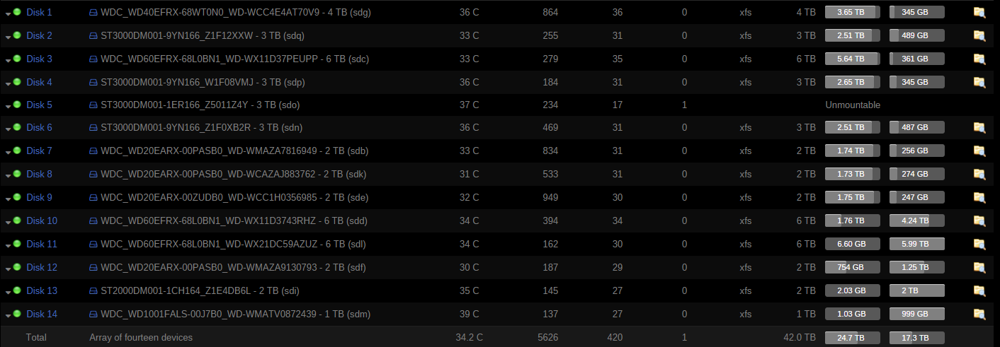

I started my Array and now my disk 5 is unmontable :S

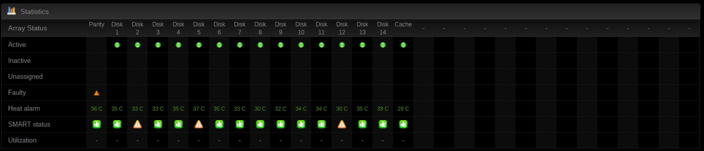

Your dashboard is showing disks 2,5,12 with warnings, but you said disk6 for some reason. Why?
And disks 2,5,12 all have actual disk problems.

Just because a drive is flagged as unmountable is that it is dead is not normally meaning that the drive is dead - just that there is file system corruption.   This is often caused by cabling and/or power issues rather than the drive itself.   Putting the array into Maintenance mode and running a file system check on the disk will show if this is the case, and then give you the option to run in 'fix' mode to make the data on it available again.
Im pretty sure this drive is about to die, i dont realy trust this seagate drive anyway i just rebooted the server and started the array in maintenance mode now my drive is mounting fine but im scare i want to copy my data to my new WD red and remove the probably faulty drive

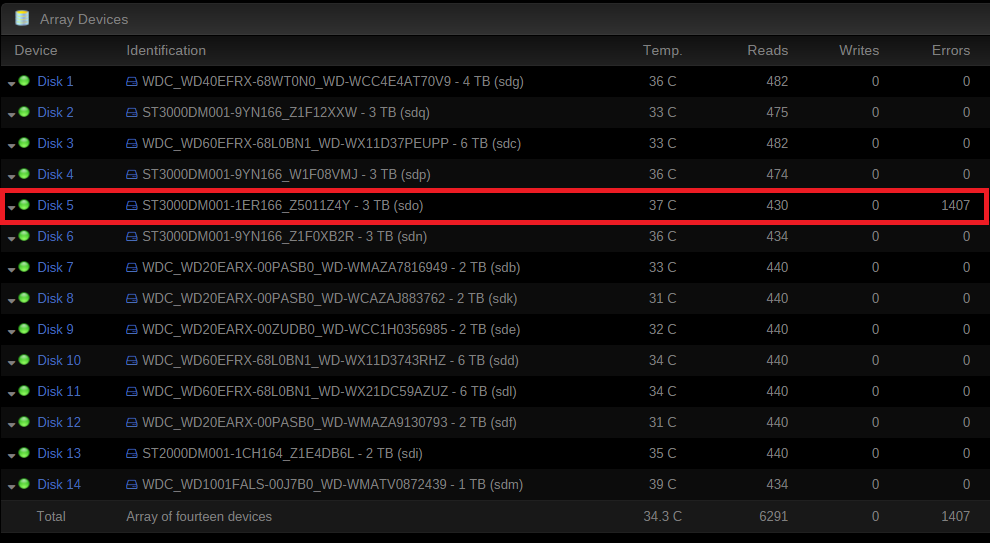

I cancel the Check because in less than 5 min i have now more than  2015 errors on this disk so i dont want to check it i want to remove it :P
Someone can tell me the best way to copy my data to another disk and removed the defective disk from my array
After a reboot the drive is now missing
Tested it with Seagate tool and the drive failed all test

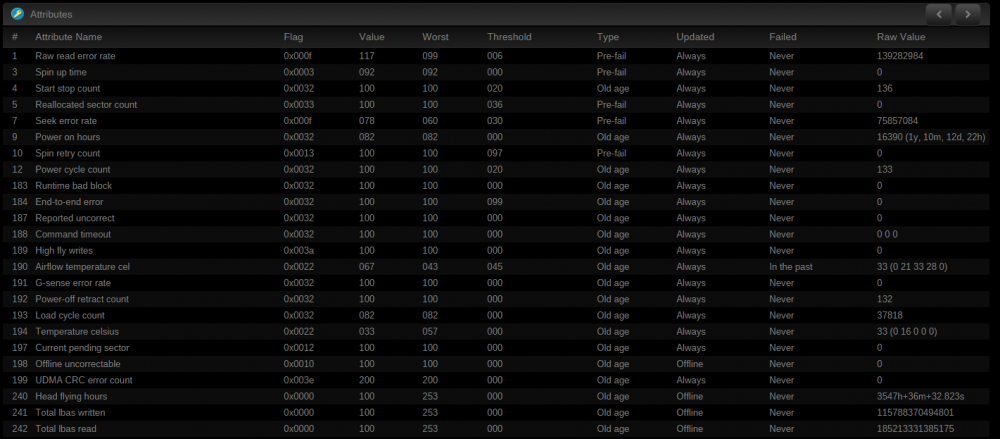

Disk 5 SMART looked OK in your diagnostics, and it didn't have any warnings on the Dashboard. Probably just a connection issue with that drive. The other drives we already mentioned should not be used in your array. Not only are they bad for any data on them, but they could compromise a rebuild of any other disk.

Disk 5 was defect i run the Seagate tools on 2 other computer and the drive was not responding also tested with 1 other sata cable. I ll backup the data from disk 2 and 12 on my pc

Are you absolutely sure disk5 is bad? I am skeptical. The SMART for disk5 was OK in your diagnostics, and unRAID did not show it as having any SMART issues in the Dashboard screenshot you posted.

You're right about disk 5 / 6. I was getting confused too. Disk5 needs to be replaced. Maybe it can't be read now. Disk6 is OK.
