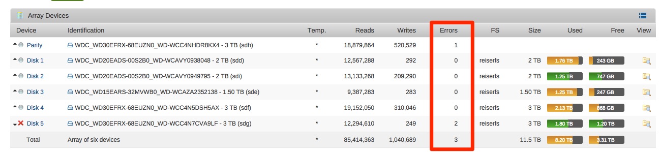

1 error on parity and 2 errors on disk5
Hi all,
I just got back from an extended leave and am now facing a few errors across two drives in my server. Could someone please help me determine what the next steps to take are? I have attached the diagnostics to this post.

SMART for all disks looks OK. Since disk5 is disabled you will have to rebuild it. Check connections. Do you know how to rebuild a disk to the same disk?

Thinking back to earlier this year, I had a problem on the same disk:
I can rebuild disk 5 again but first: is the error on the parity drive of any concern? That was not there last time.
