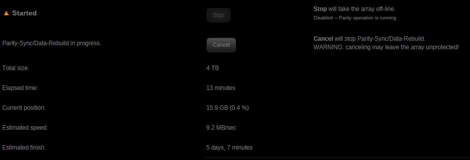

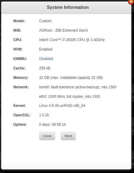

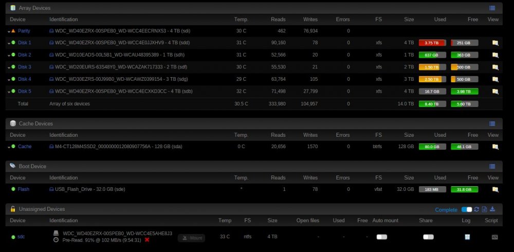

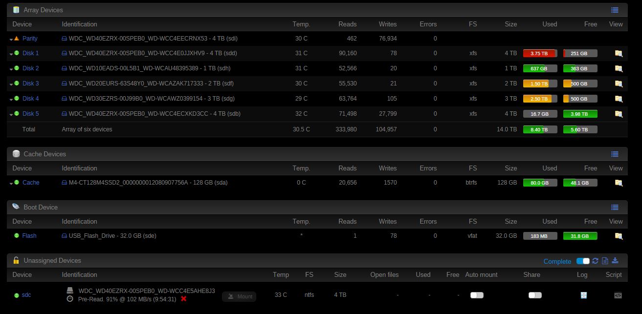

So new to the joys of unRAID but been muddling through I was on windows 10 being used as a sever before hand. with that being said I been slowly (sometimes painfully slowly) moving my data into unRAID. I just finished a preclear on a 4tb drive and went to add it and said I could not as it was larger than my parity (also 4tb) so I sucked it up and moved the parity drive to my array and set my freshpre clear to be the new parity. It is maxing out at 9MB/s for the rebuild process which seems like it is wrong. my local disk transfers were pegged between 20MiB to 500Kib a sec using unassigned devices and Krusader. When I switched over to unraid I took that time to update some of the system (Sata controller card, more memory, hot swap bays etc)  I am just not sure what to check or what could be going on. I have attached my info screenshot as well as my array and parity info.

ok after some more research which I should of done to begin with to be honest.. it sounds like it is the sata controller cards fault. Anyone have a suggestion for an alternative that wont break the bank? I need 16 ports.
