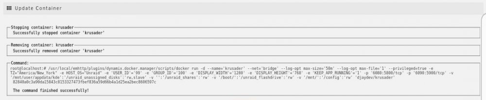

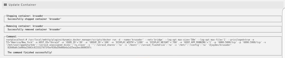

Thanks... I just found it right before what u posted.. here is all the info I think u need..Screenshot_20191211-224515_Chrome.thumb.jpg.812761d26b6e0074f43952c36e1b8c4d.jpgLog for_ krusader.PDF
I don't see anything in those volume mappings that would create those folders.

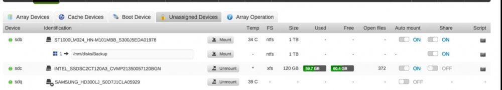

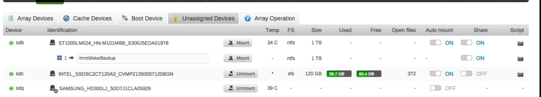

In unassigned devices I clicked the plus sign and on the drive or folder name that was there I type a new name that was /mnt/here was folder name dont remeber what name I put.. I'll post a pic of the unassigned devices and I'll find the video url to post...
This is what I did.. but this error didnt show right away I think it took a day or two.. this was when I first installed unraid. I have refreshed my usb os about 5 times since then because I couldnt figure out to to fix what i did so REDO..LOL I did figure out how to save I config from old usb to new usb... hope this helps more
This pic below is from video not my setup.. but the rename area is the same what I did.

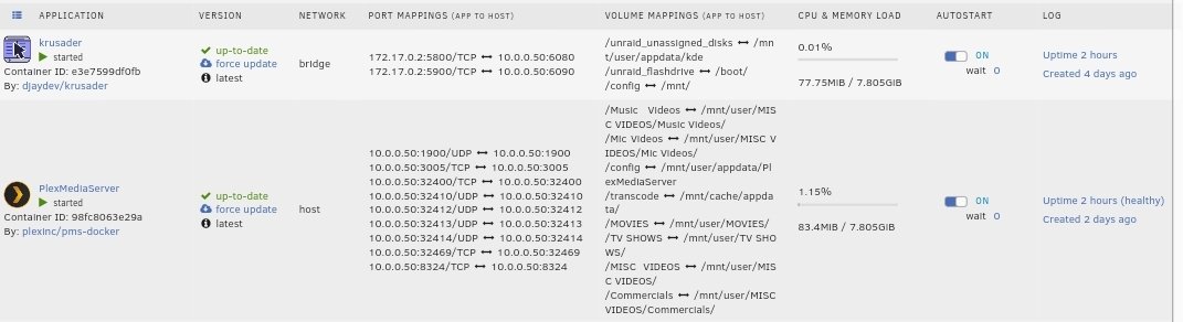

The problem is that you've set the host path for /config to be /mnt  While it's fixable, I'd suggest uninstalling this, then installing binhex-krusader.  Accept the defaults and ADD another path mapping of /mnt/disks to /UNASSIGNED
I missed that obviously

The video was probably based upon binhex's flavour of the app.  But, instead of adding another path (which is probably what the video showed), you hit "Show More Settings", then modified an existing path (the /config) which means that you stored all of the appdata for the app within /mnt (which will wind up being in RAM)
If you want to simply things, then you can simply change the /media mapping from its default of /mnt/user to instead be /mnt
