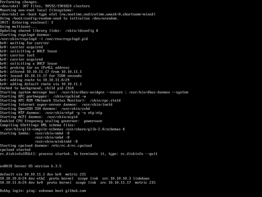

I'm experiencing an odd issue with my UnRaid 6.3.5 server.  Due to the fact I do not have any idea on how to get it resolved. I'm reaching out and appreciate any assistance I receive. Now to what's going on.
Today is the second day I ran into the same issue. It started yesterday. While I'm downloading via Crashplan docker and my daughter is watching Daniel Tiger from an SMB share. I lose connectivity to the server. No webgui no share access. I can still ping the server however.

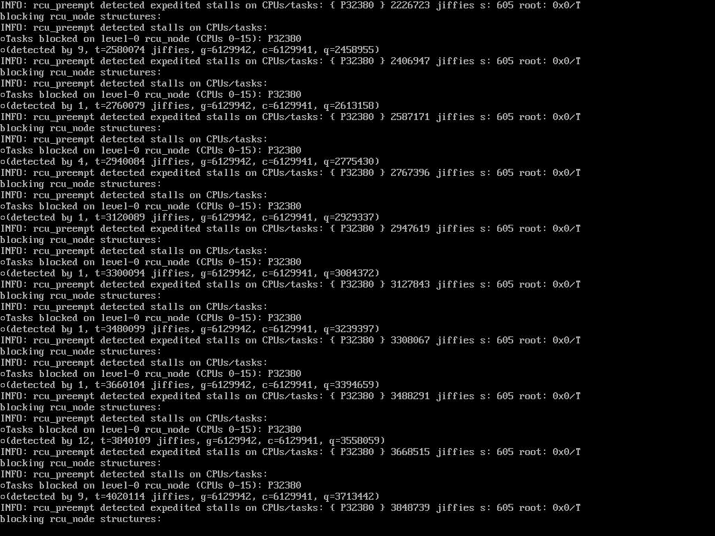

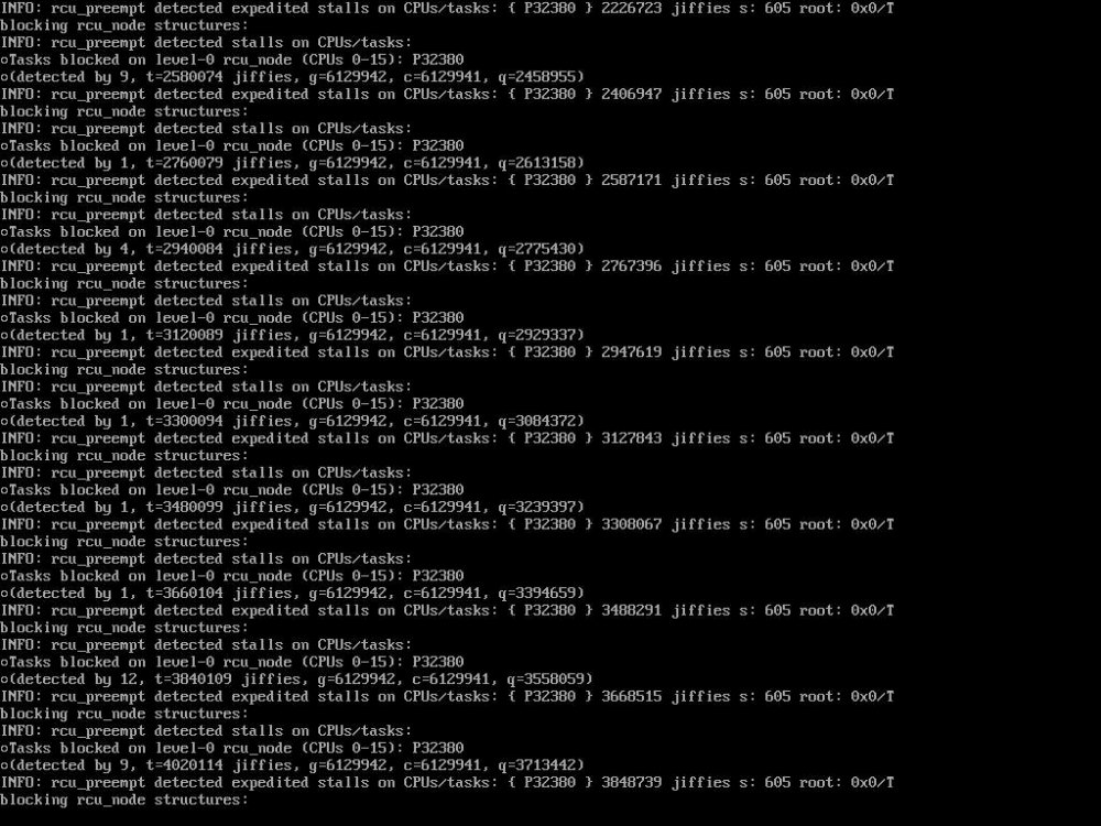

When I use iKVM (see attachment) It's as if there's an network issue. I tried reconnecting the cables and still same issue. The fact that I can still use iKVM to view the console proves networking is working because it's on the same NIC.
I tried to login via the console. But it just sits there and does nothing after I enter the login. After a long wait it seems to reset itself. Then I am able to login again. I do not like this at all because it seems to be rebooting all of my server's services.

So I finally decided to reboot the server and this is what I'm getting.
