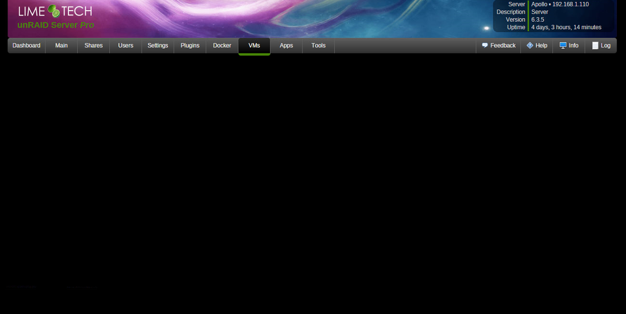

VMs tab in unraid does not populate
I have been trying to get a virtual machine setup on my server. I enabled the VMManager in settings and downloaded the ISO but when i go to the VMs tab nothing ever shows up. I have tried restarting the server and also tried disabling and renabling the manager but have not had any different results.
Any chance your browser has an adblocker installed?  If so, try "whitelisting" your server.
still no change. I tried adding it to whitelist and also disabling the add blocker all together. Also i have tried chrome, firefox, IE, and edge and all do the same thing.
Could be a corrupt or misconfigured libvirt.img, post your diagnostics.
Sep  8 04:40:36 Apollo root: /mnt/user/VirtualMachines/ is not a file
You need to specify a file, not a folder, e.g.:
/mnt/user/VirtualMachines/libvirt.img
ahh, that makes sense. that worked it looks like. thanks for the assistance.
