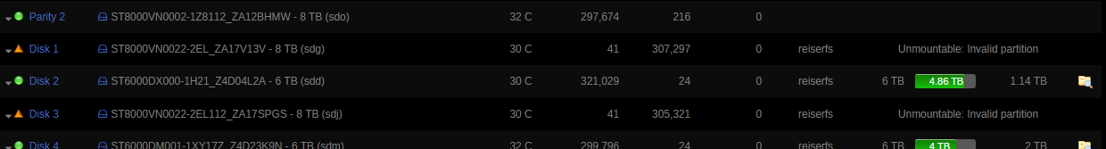

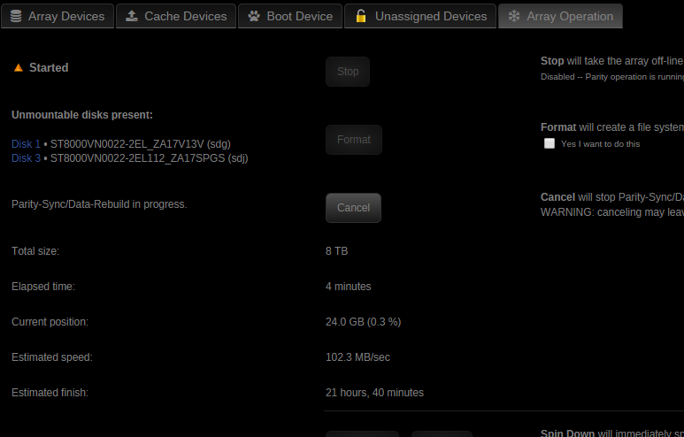

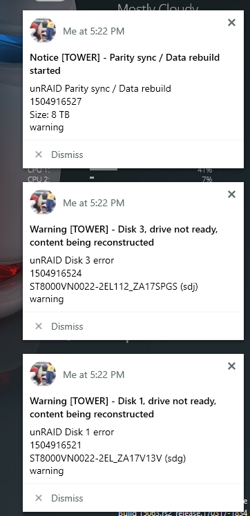

September 9, 20179 yr Not sure if this is a general v6 question or specific to this prerelease. I am replacing 2 slow disks with spanky new ones. I have dual parity and figured I could rebuild them at the same time (understanding I have no failure protection). I have started the process and as far as I can tell it's working? There is an ominous warning that the new disks are unmountable (see pic). I am just wondering if I am doing anything wrong. ps. Notifications seem to think they are both being built. Edited September 9, 20179 yr by interwebtech

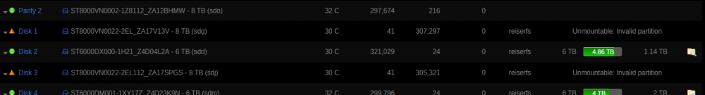

September 9, 20179 yr Author should I stop and format them and then restart the build? Showing as unmountable in dashboard too.

September 9, 20179 yr 5 hours ago, bjp999 said: Makes sense they would be unmounted while they are being rebuilt. The fact that the GUI is reporting they are unmountable and offering to let you format them seems like a problem. @bonienl might want to look into that. When disk(s) are being rebuilt they go to emulated state and appear as normal working condition. The fact that a unmountable error is displayed means there is something wrong with the disk, the rebuild won't be succesful in this case.
September 9, 20179 yr I could reproduce this, @limetechthere's a bug in rc8, both single and dual parity rebuild are not working correctly, emulated disk(s) show "unmountable: invalid partition" P.S.: rebuild works correctly if it's done to a previously partitioned disk, it doesn't if it's done to a new/cleared disk (starting the array with an emulated disk doesn't work also). Edited September 9, 20179 yr by johnnie.black

September 10, 20179 yr Author It appears the disks being rebuilt are not being emulated? Disk 1 & 3 are missing from the shares they belong to and the files are not available to plex.
