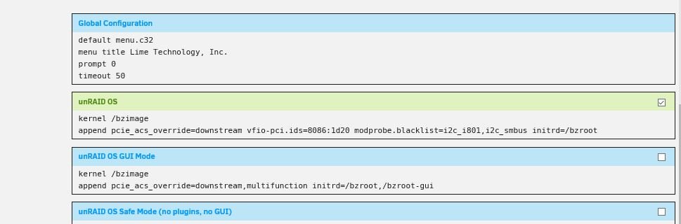

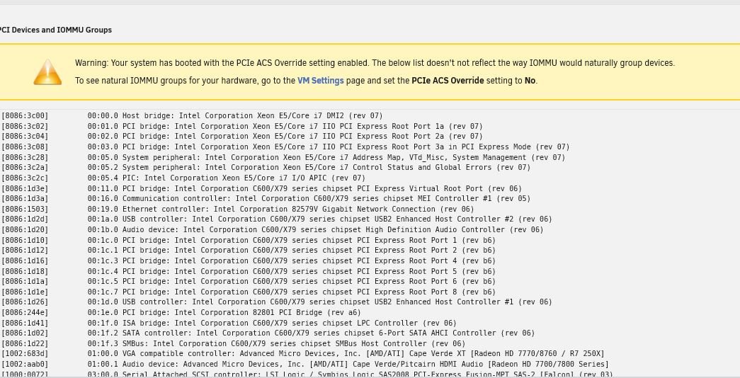

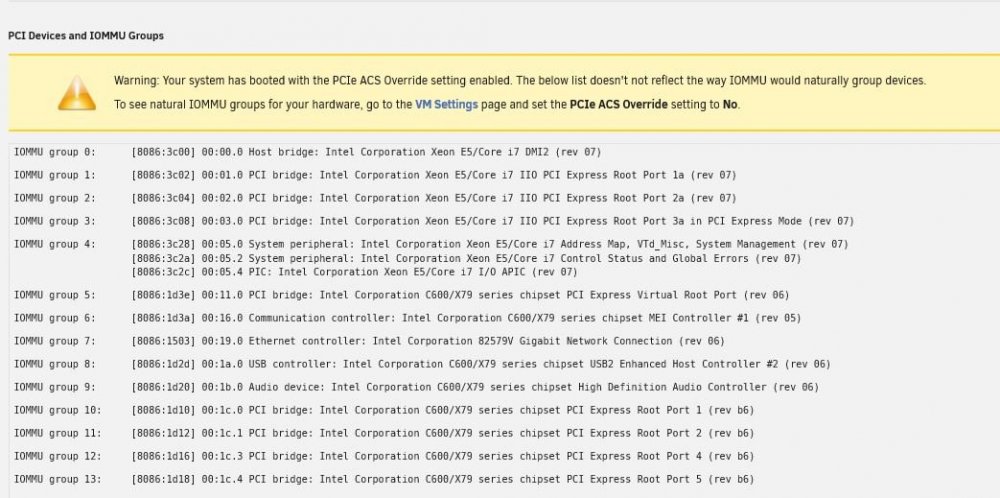

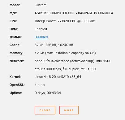

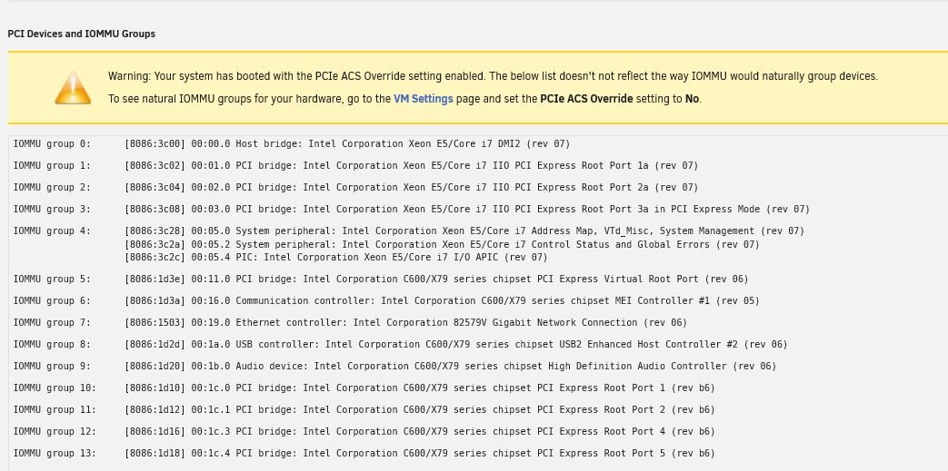

hi I tried  the setup  of the ACS OverRide.. I set it to Both  as it didn't say which one to set it in the instructions
but I can not get it to work  to get the Audio device to show up
Can you send a picture with the IOMMU groups?  You cropped out this information in the last picture. Also sometimes you need to add it directly in VM XML instead of using the VM GUI, it should look like this:

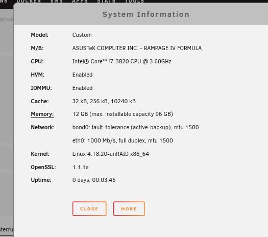

I dunno how to do that but if it helps the IOMMU is disabled  in the info
You need to activate the intel vt-d or amd-vi feature in your bios. You can watch this video if you want more information :
got it enabled..

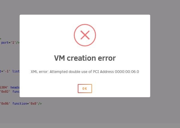

am I supposed to add that in the devices under the xml advanced mode of the VM if so I did that
for my windows 10  and I got error

Change this line :
For this one :
 Or whatever slot number that you are not currently using, it doesn't matter.
ok I set to 8  and saved and then hit edit.. nothing in the PCI
and how come I don't get a list of USB options etc it shows from spaceinvaders list
and I have no idea what slot im using I only use 1 slot in the computer for a LSI raid card
I don't know either why you cannot see it through the GUI, but since you've added it manually, the VM should recognize it. What happens when you launch the VM? No error message?

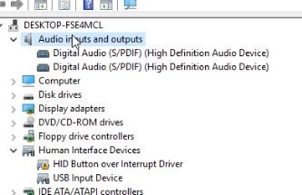

soo I took pic of Windows 10vm and Windows 2016 server
win10 shows spdif  but shouldn't it be labled like Realtek digital output
and under windows server shows remote audio
is that how its supposed to look
I gonna add cable to the back of the board for the speaker output to see if it works  as I trying to run the Radio streaming through a VM to my speakers
Have you installed the sound card driver? By default windows will provide a generic driver. It is also possible that there is some magical VM voodo going on.
