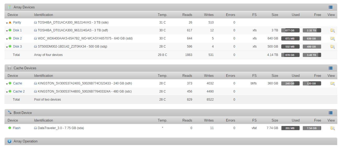

I've added a second drive to my cache pool a few days before the power loss. It shows that the total size is 360 GB even though the disks sum up to 740 GB. It also says that there is 120 GB free :x.
Available space is incorrectly reported when using 2 different size devices in raid1, real available space is the size of the smaller device, 240GB, hence the out of space errors.

For whatever reason, I thought cache pool was a raid0 config. It makes sense now. The biggest drive is marked unmountable when used alone in the cache pool.
I'll save the cache data on one of the HDD, format the 480GB Drive and put the cache data back on it. Then, only use that one in the cache pool.
Hopefully, it'll do the trick and I'll be able to see my dockers & vms ...
