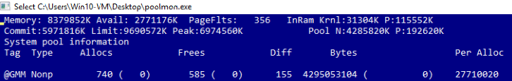

Following up my last post, I looked at my pool memory with poolmon and I've found that my IGD is indeed taking up 4.3Gb of memory. I'm now trying to found why.
@GMM - <unknown>    - (Intel video driver) Memory manager
