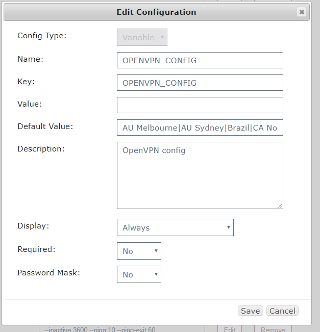

in my initial post above, there is a note and a link to the openvpn config files/names for each provider, If you arent using PIA then you need to change the values to suit the provider per the names under your provider at the link for pureVPN these names :
https://github.com/haugene/docker-transmission-openvpn/tree/master/openvpn/purevpn
you can add then to the drop down in this format:
belgium-tcp|belgium-udp|bulgaria-tcp|etc.....
I added all the PIA ones as default for easy switching, but if you dont need to switch ever, then just add the ones you like!!
Edited by clowrym
Ah... Where do I edit the drop down options?  I just deleted the whole field and re-added it so I could just type in the value.
If you clisck edit the field and add the values in the default section:
