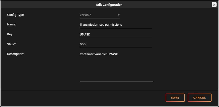

On 10/14/2019 at 11:39 AM, SolidFyre said:
Hi!
I'm having an issue with the Transmission_VPN docker image regarding the UMASK settings that is driving me nuts. Hopefully someone could nudge me in the right direction.
I am unsure of the correct variable name, according to some variable chart I found all variables are "TRANSMISSION_WHATEVER" (which worked for all other variables I have set), however that did not seem to work for umask so I switched to just "UMASK" as variable, but still can't get it to work.
For some reason I get this in the download folder:
Topfolder = drwxrwxr-x 1 nobody users - Can't edit
Subfolder = drwxrwxr-x 1 nobody users - Can edit
Files = -rw-rw-r-- 1 nobody users - Can edit (and execute...?)
How come the same rights, topfolder and subfolder behave differently when browsing samba?
Download folder is accessed using a unraid user with R/W access (private samba share), are these settings interfering?
Whats the correct variable and setting to use to have it set 777 (or at least 775) on all folders and files?
Right now I have the settings like this:

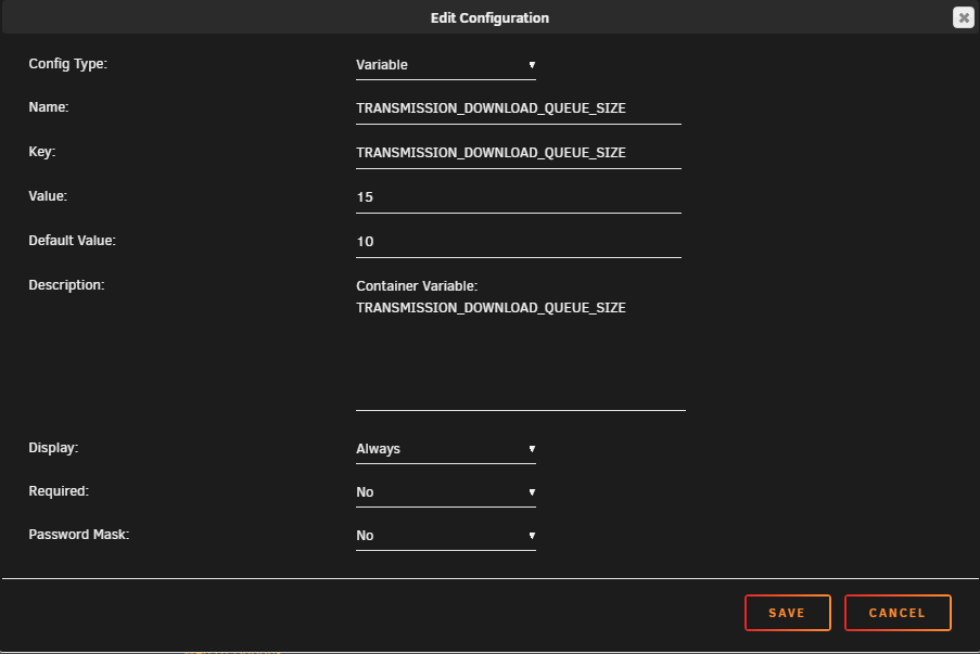

I've never used this particular setting, But I believe your key should be set to TRANSMISSION_UMASK ,  not just UMASK
Basically any variable you see here or here can be added to your docker template with TRANSMISSION_whichever_setting_you_want_to_be_Static_after_reboot_of_the_container set as the key as you indicated in your post.
For instance, I have my Queue size set :

Yea, those lists.
Problem solves itself by using the "Safe docker permissions" thingy, but as soon as I download something new the rights gets broken.
Hmm, well it seems that I was correct using TRANSMISSION_UMASK as I did at the start, I have now switched back, will try with some small downloads.
What I have read, 000 is the same as 777 so I am going back to this to try again, maybe I missed something.
Thanks, will report back my findings.

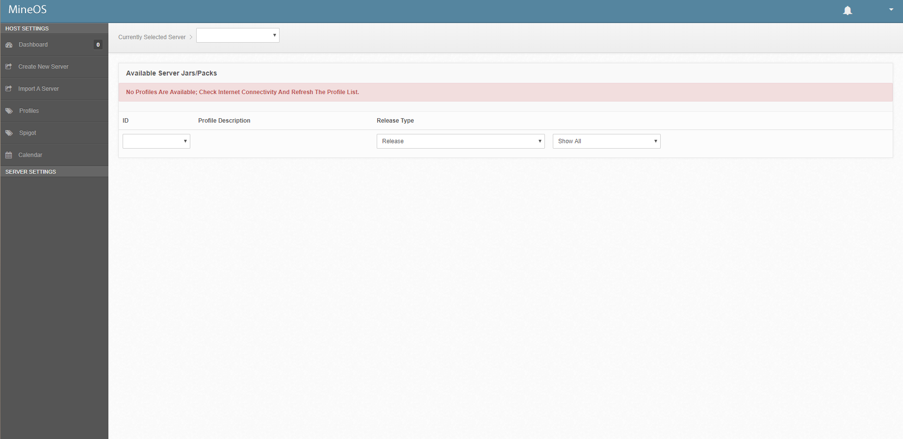

I also have the same problem with the "profiles" tab as another user:

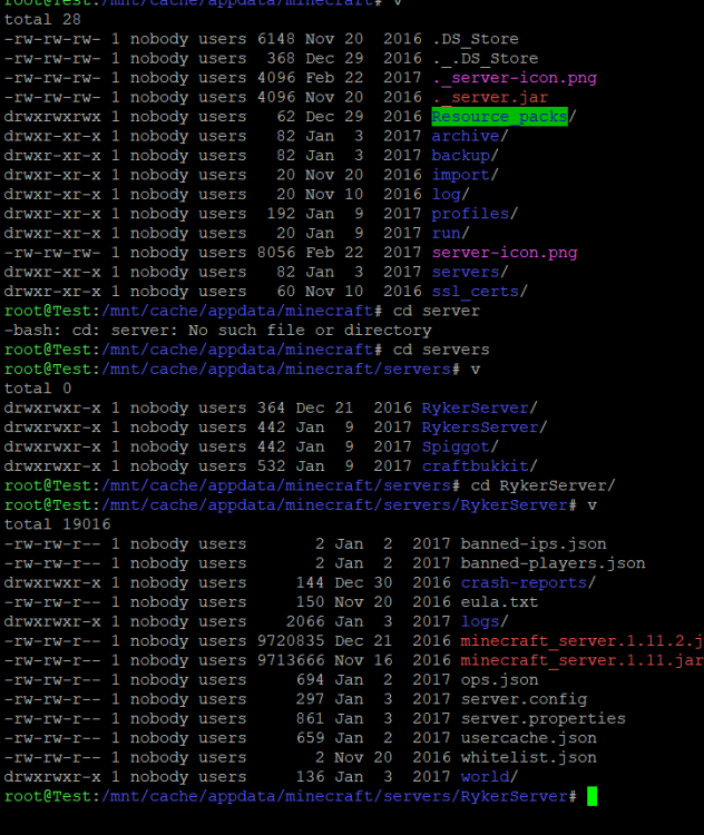

what is the user/group on the folder /mnt/cache/appdata/minecraft?
It should be just Public, here is a screenshot:
Edit 5 minutes later: I tried running the container... and now it's working again? I've changed nothing since last time? I'll see if it breaks in the future again.
Edit again; after a restart it is no longer working.
Edited by wesy32

I was talking more about this:
I've had similar issues to you when these permissions werent correct
Hi, here are my settings:
looks as though they might be my issue.
