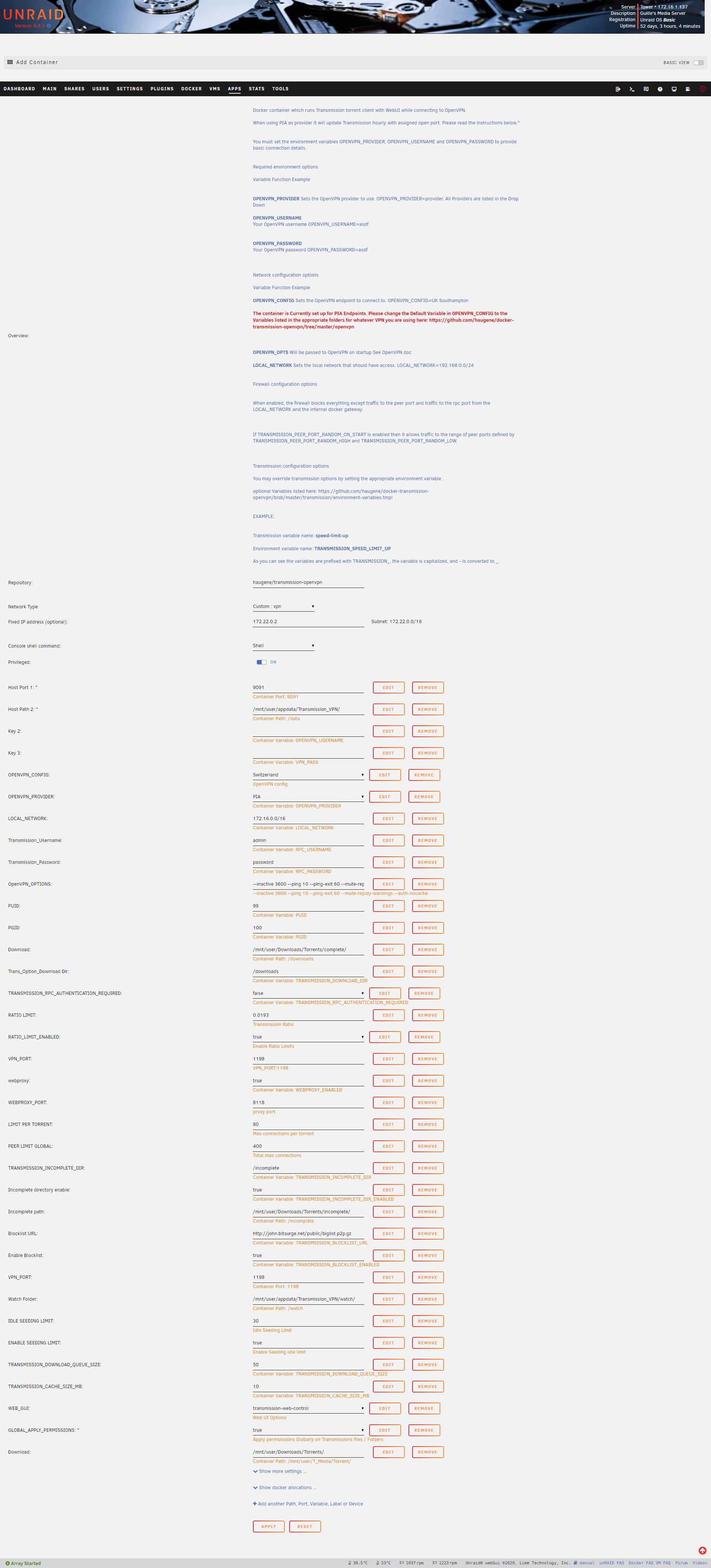

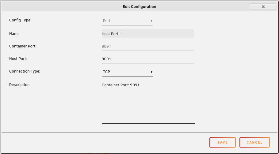

I seem to be having a few issues with networking in the Transmission docker.
First off, if I set the network to Host, then unRAID and all the dockers also run though the VPN.
But if I change it to bridge then the docker run fails. See below.
root@localhost:# /usr/local/emhttp/plugins/dynamix.docker.manager/scripts/docker run -d --name='Transmission_VPN' --net='bridge' --privileged=true -e TZ="Pacific/Auckland" -e HOST_OS="Unraid" -e 'OPENVPN_USERNAME'='user' -e 'OPENVPN_PASSWORD'='password' -e 'OPENVPN_CONFIG'='AU Melbourne' -e 'OPENVPN_PROVIDER'='PROTONVPN' -e 'LOCAL_NETWORK'='10.10.1.0/24' -e 'TRANSMISSION_RPC_USERNAME'='user' -e 'TRANSMISSION_RPC_PASSWORD'='password' -e 'OPENVPN_OPTS'='--inactive 3600 --ping 10 --ping-exit 60' -e 'PUID'='99' -e 'PGID'='100' -e 'TRANSMISSION_DOWNLOAD_DIR'='/downloads/complete' -e 'TRANSMISSION_RPC_AUTHENTICATION_REQUIRED'='true' -e 'TRANSMISSION_RATIO_LIMIT'='1.1' -e 'TRANSMISSION_RATIO_LIMIT_ENABLED'='true' -e 'TRANSMISSION_DOWNLOAD_QUEUE_SIZE'='5' -e 'TRANSMISSION_CACHE_SIZE_MB'='10' -e 'TRANSMISSION_INCOMPLETE_DIR'='/downloads/incomplete' -e 'TRANSMISSION_WEB_UI'='transmission-web-control' -e 'GLOBAL_APPLY_PERMISSIONS'='false' -e 'OPENVPN_CONFIG'='sg.protonvpn.com.udp' -p '9091:9091/tcp' -p '1198:badco/udp' -p '1198:1198/udp' -v '/mnt/user/appdata/Transmission_VPN/':'/data':'rw' -v '/mnt/user/downloads/torrents/':'/downloads':'rw' -v '/mnt/user/downloads/watch/':'/watch':'rw' -v '/mnt/user/downloads/torrents/complete/':'/mnt/user/T_Media/Torrent/':'rw' -v '/mnt/user/appdata/Transmission_VPN':'/config':'rw' --restart=always --log-opt max-size=50m --log-opt max-file=1 'haugene/transmission-openvpn'
/usr/bin/docker: invalid publish opts format (should be name=value but got '9091:9091/tcp').
See '/usr/bin/docker run --help'.
The command failed.
I'm not sure why that port format is wrong, I haven't touched those settings.
Edited by BadCo.
I beleive this is your issue:
-p '1198:badco/udp'
it should be 1198:1198/udp
-p '1198:badco/udp'
What the hell? I can't understand why the run command has that strange port allocation, it isn't in the template anywhere!?
EDIT: I noticed the port is mapped correctly next to the incorrect one
EDIT2: Clicked advanced on the template and found multiple port mappings with 1198 mapped to badco and a directory path. Removed them both and the command finished successfully.
Thanks for the heads up @clowrym!
Edited by BadCo.

For issues with config getting removed, it happens because is not listed in the template. People please, create the variables accordingly. You can follow this link
https://haugene.github.io/docker-transmission-openvpn/arguments/
I've attached a reference picture for my setup. Also follow this post if your disks spin up constantly when transmission is running.
screencapture-36251eb0052f4a318d86fb00e68bb3a12e2684f7-unraid-net-Apps-AddContainer-2020-06-06-18_14_09.png
